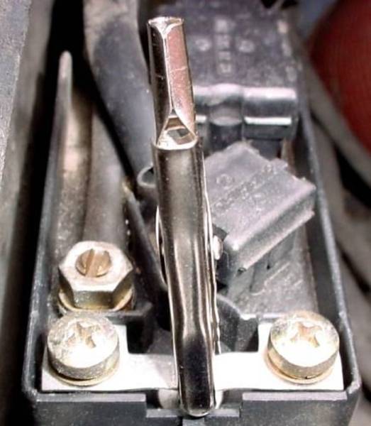

Some other problems they can cause is they can crack. When I first looked at mine I did not notice the crack and thought it was OK. Later when the light was better I saw the Crack.
See Pics.
I had a new Fuse but was afraid to keep it in the car as I thought it would get lost. But, I could not remember where I put it either. So, I put the pictured Clip on and drove the Car like that until I found the Fuse abuot a week later.
Another issue I have read about is a where a person found both of the Fuse screws loose.
Attached Thumbnails 1987 300dt fuel delivery issue-fuse-gp-relay.jpg   1987 300dt fuel delivery issue-w-glow-plug-fuse-clipped.jpg
