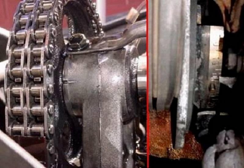

Another thing that can effect starting is if the Camshaf Timing is late due to Timing Chain Stretch/Gear Wear.
You can get a rough check of this by lining up the Timing Mark at the Rear of the Camshaft Gear with the Timing Mark on the Front Camshaft Bearing Tower; but do that exactly.
Then look down at the Crankdamper Degree Marks and see what the Pointer points to.
When your Engine was new it was liked up on OT (that is top dead center).
As an example at a little over tewnty thousand Miles My Engine as 2.5 degrees of late Camshaft Timing. That is normal for that amount of miles.
If you have 4 degrees or more there is offset Woodruff Keys to restore the Camshaft Timing. However, at that point you need to do what is called the 2mm Method to determine the exact amount and what Woodruff Key to use.
But, the rough check will give you some idea what is going on.
The below pic is a split one. The left is the Camshaft Gear lined up with the Timing Mark and the right side is a pic of the Crankdamper degree marks and Pointer. The Pointer is somewhere between OT (top dead center) and 2.5 degrees.
