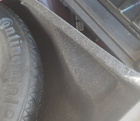

Smile GLS450 2017 AUX battery location
2017 GLS450 (166) Aux battery is a small size in a snap in holder with clip power connections LOCATED rear passenger side below deck rear next to tire well ... in front of wolfer speaker.
MB battery N000000004039 ($ 52 AND UP) 12V 1.2 Ah
Lift spare tire lid ... from rear on right side (passengers side) there are (2) Two plastic snap clips hold the tire well carpet to the frame. Carpet can be pulled down to get access to battery.
