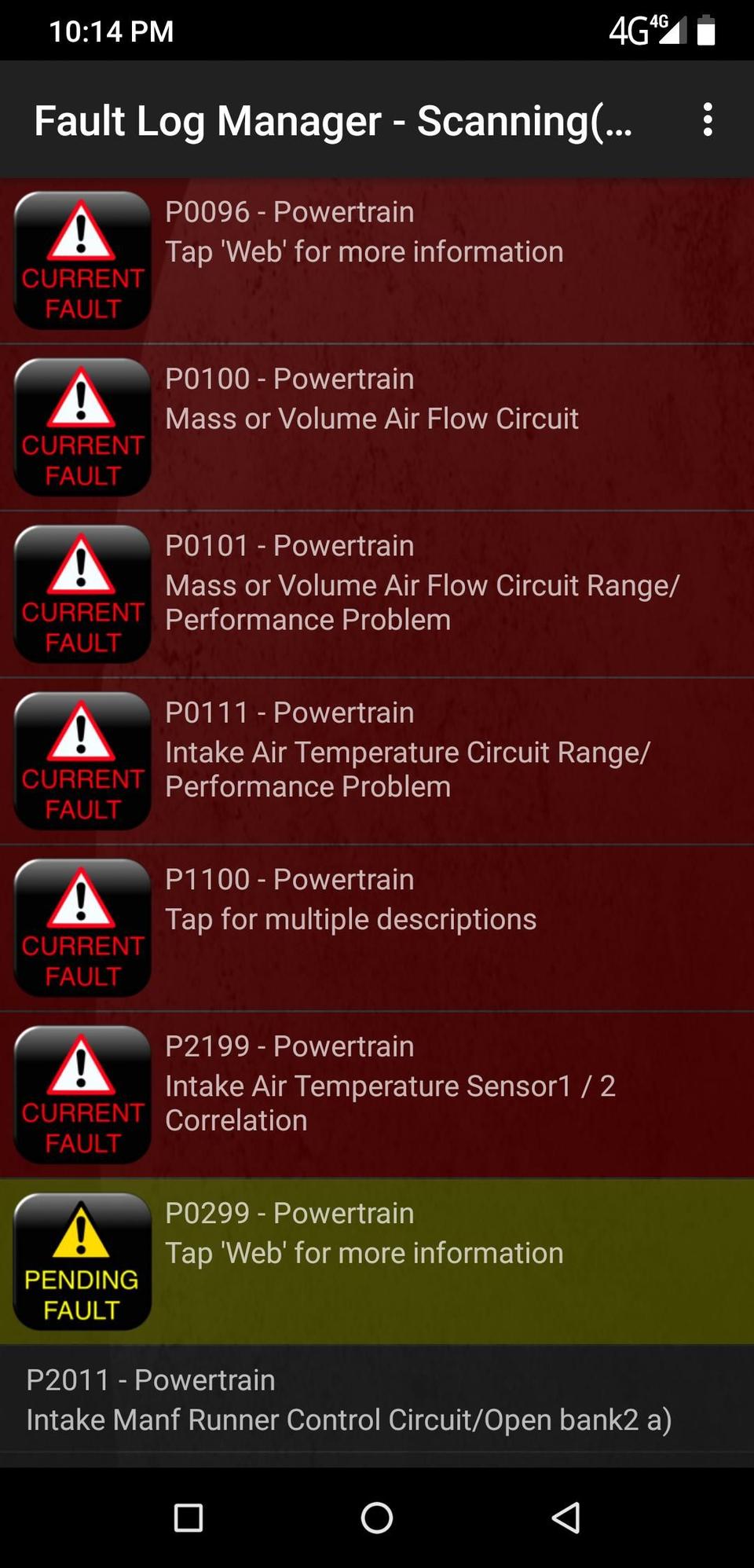

The car suddenly started to not accelerate and hesitate. Won't go over 40mph and uphills it is terrible.
I read the OBD II codes Photos attached) and multiple codes came up including O2 Sensor bank 1, sensor 2. So I replaced it for $95, a bosch brand.

Car has power steering and all works, I forgot to mention when the car does pickup I hear this air suction/hissing sound but then goes away. Wondering if it's the TurboCharger and if it is then is the whole turbo bad or I should get just the turbo charger electric motor which is that electronic black part on top of the turbo. Problem .is testing all this stuff and seeing what doesn't work. There is no help or guide on testing parts before randomly buying parts.
To summarize :I Replaced
1. O2 bank 1, sensor 2
2. Air intake center tube with both brand new MAF sensors
I still have CEL (check engine light)
OBD II has other codes such IAT (intake air temperature) faulty.
Tons of multiple codes say power train issues (possible transmission failure), but shifts fine.
Any one have any ideas what I should try next? IAT sensor is only like $18, but not sure if the issue.
I am looking at accelerator sensor too, but rather try to test it before replacing.
OBD codes still showing which I have tried several times to clear:
