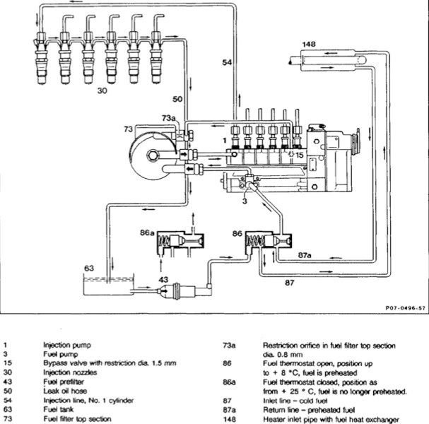

My '83 300d, does not have a primary fuel filter. Can someone please share pictures with me, showing me how to hook one up. I don't know where the hose should start or end, that goes to and from the primary fuel filter. Thank you!

Hi Steven - take a look at the link below, although it's the replacement procedure; it should still give you an idea of how to install. If you have any further questions, feel free to post a Comment just below the article and one of our techs will get back to you with more details. Hope this helps and best of luck!

according to this picture the primary fuel filter should be attached to the line coming from the fuel tank and going to the fuel thermostat.
Does anyone know if this picture is correct for a 1983 mercedes-benz 300d?
