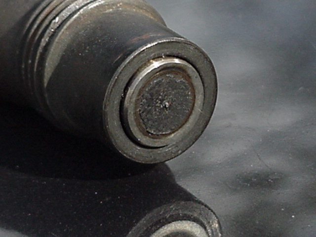

Vegetable oil does not burn completely and its dirty. It coats the combustion chamber with carbon and sludge (injector pictured), sticks the piston rings causing low compression, contaminates the engine oil, has food fats and acids that no amount of filtering will remove, congeals at temperatures well above freezing, makes the car smell like a burning McDonald's fryer and spillage is inevitable and a royal pita to get out (both from the interior and paint).
