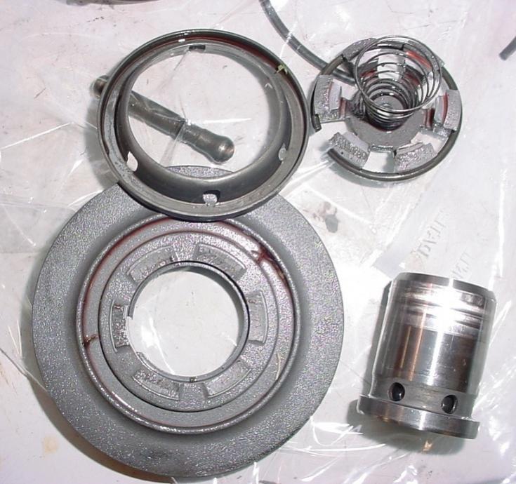

I am trying to post a pic of My Broke B2 Piston. The large circular part stayed in the Bore; the rest falls out loose as you remove the Cover.
There is a larger Spring not shown in the Picture.
