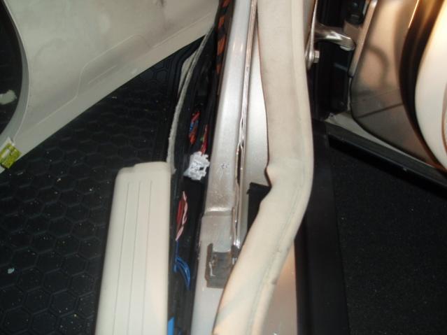

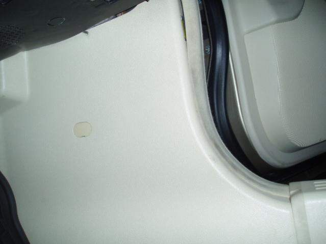

Installing Satelite Radio Aux. Input in my 2005 C 240 wagon
This was so easy I could not believe it. I took pics so I could post them here but have never done so before so patience please.
On passenger side of car there is a white plug along bottem of kick panel to recieve an aux. input for a Satelite Radio or Ipod. check to make sure it is there before ordering the part from MB (#A 210 440 50 05 ) also if you look real good inside the right side of glove box near top you will see an outline of a circle that is where the input will be when finished.
1st Open glove box if you look good there is a small slot to put a small tool in to remove the right side dash panel, see pic 1
2nd Pry up seal plate part way (you do not have to take it all the way off) pic 5
3rd remove cap and screw that holds kick panel pic 4
4th Pull up door seal to expose locating clips of kick panel and remove kick panel pic 3 next reply
5th Cut from outside to inside hole for aux input at top of glove box 4 very small ribs that hold the plug in place. pic 3
6th Plug in wire harness of aux input at white plug that you located at bottem of kick panel and coil extra wire someplace so it does not get pinched when you reinstall kick panel. pic 4 next thread
Reinstall in reverse order.
At radio with key on -----hold down CDC button on radio until you see Aux input .
To be comtinued

more pics
The last pic is how I will get power to my Sirius with a fuse tap now to find a convient location
Good luck to anyone who does this it is easy!!!!!
I will update when done.
Attached Thumbnails I just finished installing AUX input for satelite radio 05 C240-09-28-2010-025.jpg   I just finished installing AUX input for satelite radio 05 C240-09-28-2010-026.jpg   I just finished installing AUX input for satelite radio 05 C240-09-28-2010-027.jpg   I just finished installing AUX input for satelite radio 05 C240-09-28-2010-029.jpg
