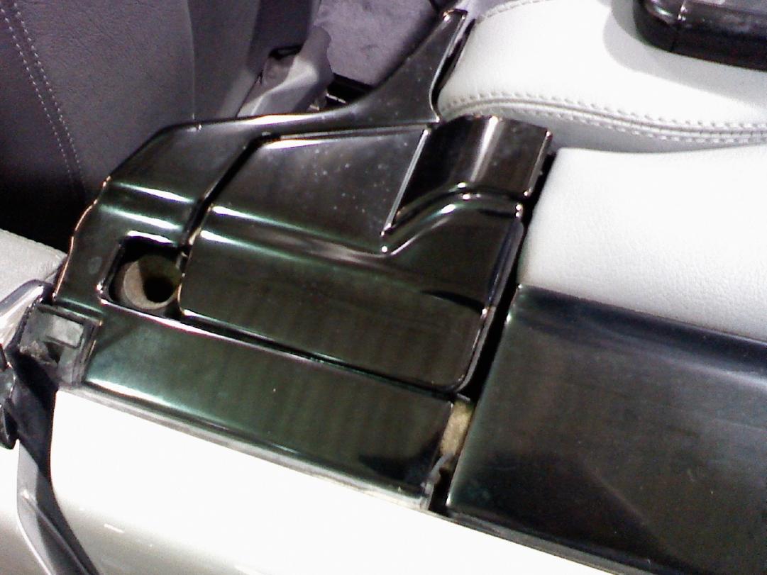

here is what it should look like

are they spring loaded or something, or do they just not move and cover the holes ? i am going to try to source some, i bet this is a hard part to find. what year is your car?

On my 97 SL320 they are spring loaded.
