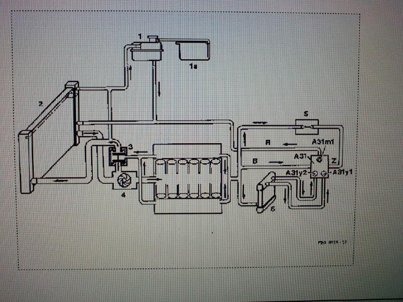

not sure if these are what you want or if youve already seen them but here they are. i wasnt sure how to send them threw a PM so ive put them in one of your posts.
Attached Thumbnails how to use on board aircon module for diagnosis-v12-cooling-system.jpg   how to use on board aircon module for diagnosis-v12-cooling-system1.jpg

chassis 221 many thanks yes indeed that is the diagram i need.
