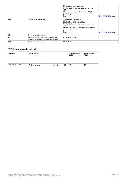

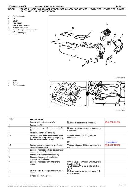

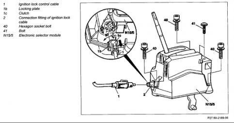

BTW, attached are the pages from mercedes manual showing most of the key steps removing shift unit. I found these moderately helpful but the utube video below was the most useful...watch it frame by frame before doing the work.
