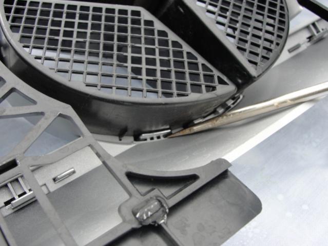

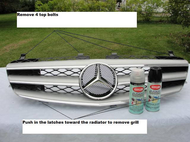

Here is how:
Remove top (4) bolts and push in (3) bottom latches toward the radiator.
Attached Thumbnails Removed front grill and painted black on 2008 R350-dsc00138.jpg   Removed front grill and painted black on 2008 R350-dsc00140.jpg   Removed front grill and painted black on 2008 R350-dsc00144.jpg   Removed front grill and painted black on 2008 R350-dsc00145.jpg   Removed front grill and painted black on 2008 R350-dsc00150.jpg

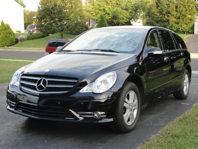

Final finished pic. of black front grill on 2008 R350.
Attached Thumbnails Removed front grill and painted black on 2008 R350-dsc00151.jpg
