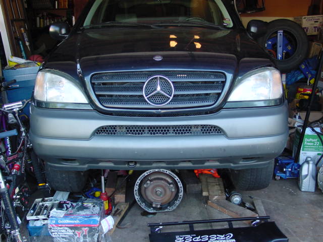

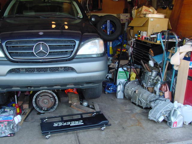

Talking Transmission service
This is called full transmission service DIY in your own garage. One whole day under it and you are back on the road! One man (owner) operation.
