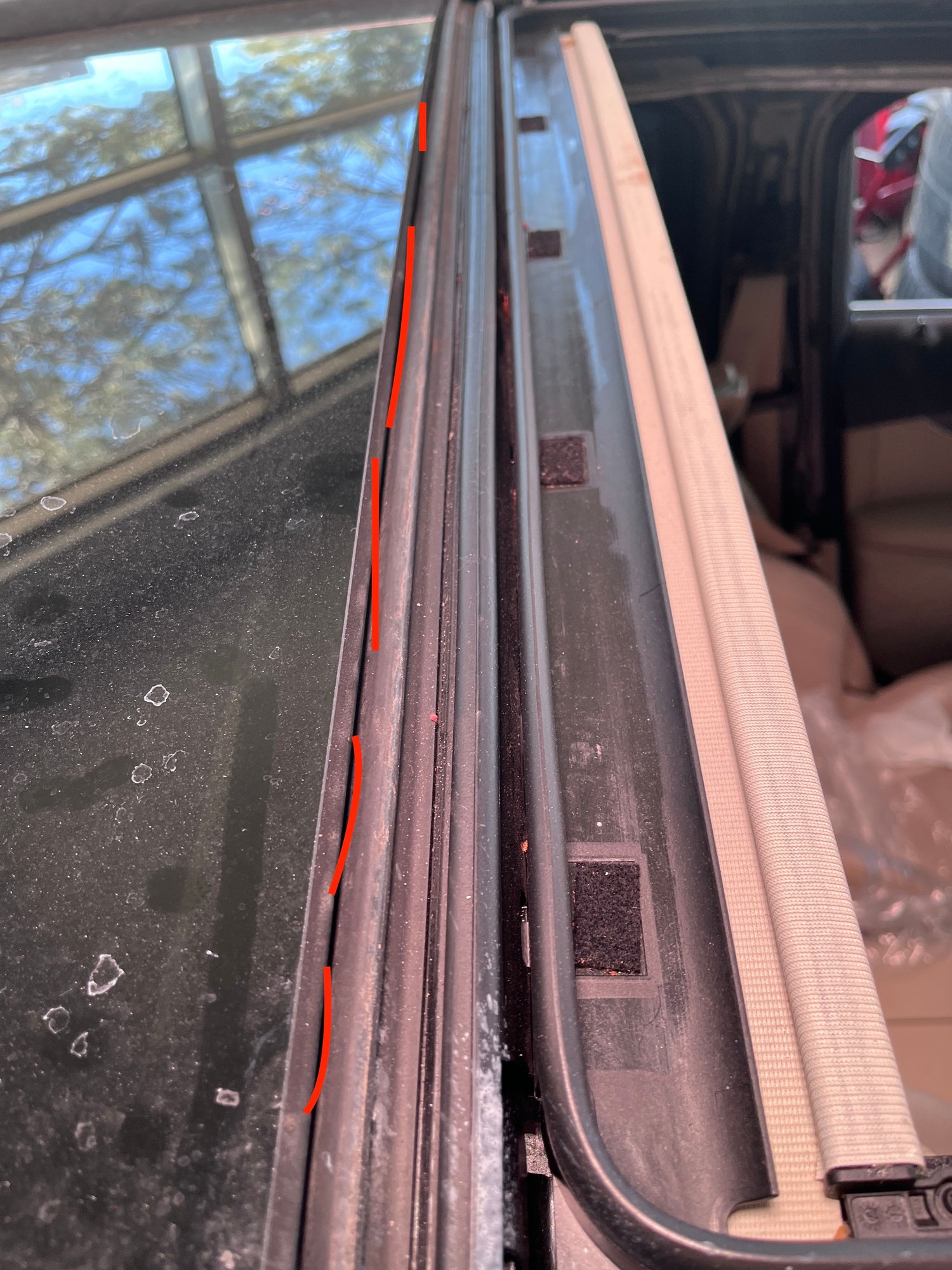

I have the same problem with my GLC300 2016, and I just tested it with the mechanic at MB.
Turns out the seal on the back 'non moving' part of the panoramic sunroof has failed. If you poor just on that seal it will come out on the sides in the back seat as you described (the water travels into the roll up guide of the sun roof shade, out to the edge and then drips).
To see this in action you need to remove the headliner.... not cheap or fun.
The fix is more simple.
1) replace the back sun roof glass (1500 to 4500 usd, depending on who does it) - this is a permanant fix
2) seal it in place
RE option 2: this product was recommended - but it might be a bit tricky to get into place
Amazon Amazon
It was recommended to use a plastic spatula... I have not tried it yet.
Does anyone have any experience with this? Or recommend a different product?
