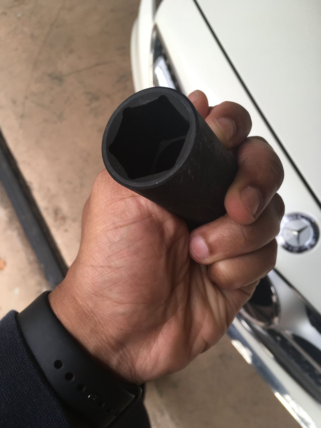

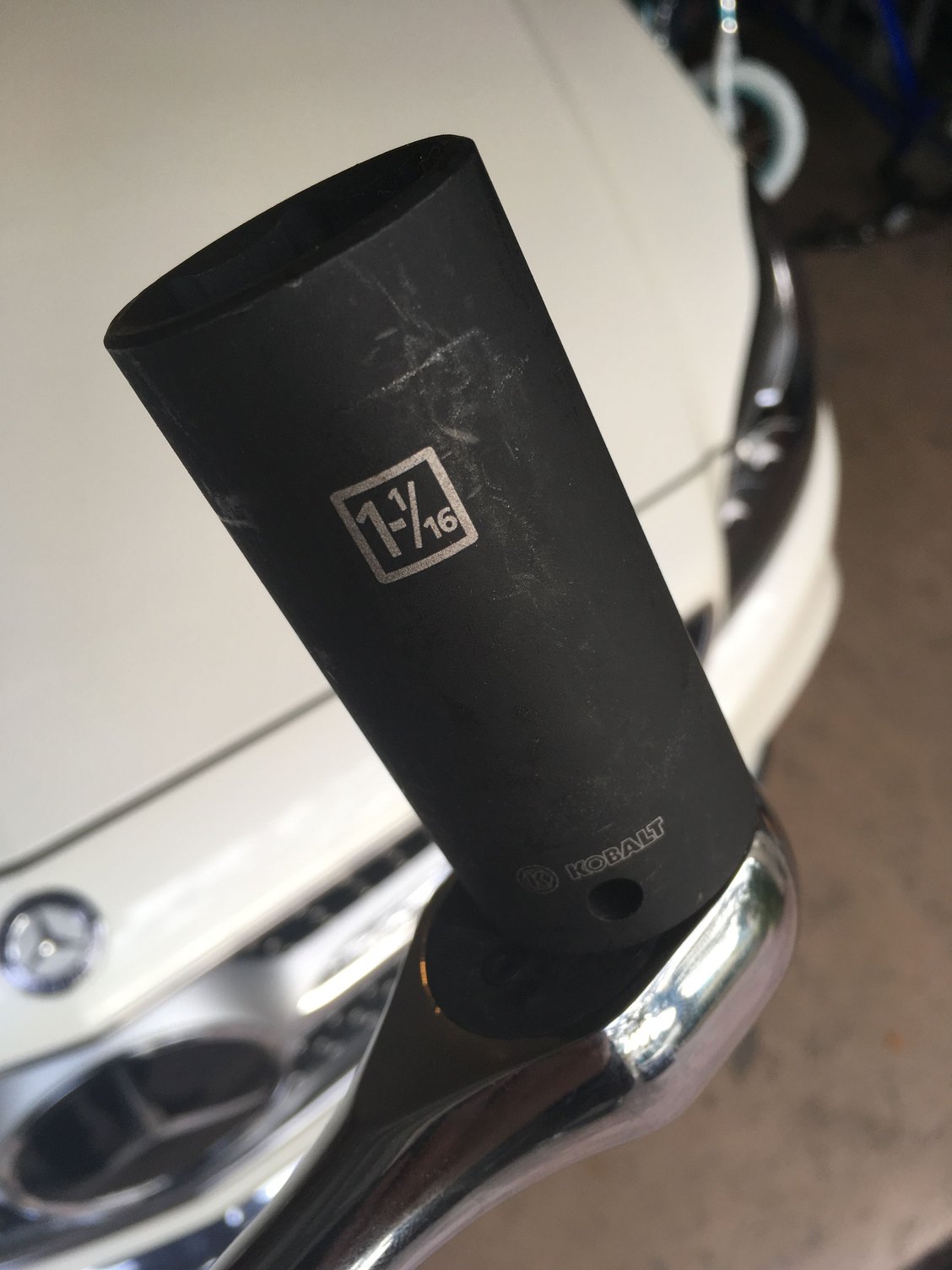

fyi, turns out you dont need to go out of your way to get a "oil filter wrench"
example of oil filter wrench
looking in my garage i found the following which will do just fine
2016 cls550 oil filter housing

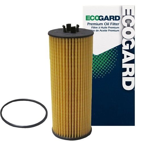

I ordered oil filter A2761800009 (this was what was even listed on my invoice from dealer for service A). however that part does not fit my 2016 CLS550
Furthermore, when I removed the current filter I have an its actually a "Hengst AMG A2781840125"
So the dealership invoiced the wrong oil filter. Go figure!
I will now order a ECOGARD X10186 Cartridge Engine Oil Filter
what i ordered...
OEM A2761800009
the oil filter that was currently in the CLS
what i will now order
