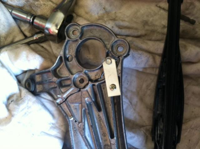

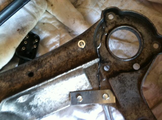

Default I FIXED IT and cost me NOTHING
My wiper will never park correctly where it should, it has been over 2 months now, when I turn off the wiper (switch) it parks at 10 O'clock in front of my face. So in view that the wiper works, it is not the motor, in view that the wiper works in all speeds, it is not the fuse or relay, so what is it then? Well today, I removed the whole assembly and put it on the floor and found that the aluminum RACK is broken, so the assembly is in two pieces, and so I fixed it, SEE PHOTOS, I drilled 4 holes on the rack, attached 2 brackets, and now the bracket feels very strong, I put everything back the way it was, and tested for the operation and all is successful, the wiper parks where it is supposed to, it cost me nothing, just 4 hours of my time in the garage. If the wiper will last 2 or 3 more years, I will be happy.
Attached Thumbnails M wiper does not go to rest when shutting it off-wiper-rack-alluminum.jpg   M wiper does not go to rest when shutting it off-wiper-rack-broken-w202.jpg
