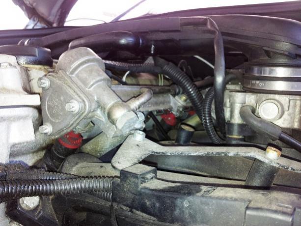

He said, they're really easy to swap. So, I tried to identify the packs. I couldn't work out where they are and how to access them. I'm not a dufus and have previously serviced my older cars with ease. However this is my first Mercedes and I'm out of practice. I've attached pictures of my engine and would appreciate any advice, direction & guidance any of you can offer me.

I beleive coils are under the cover as I have shown in your original image attached. You will have to remove Air Pipe above this cover before you can open the cover where all spark plugs and coils are located.
