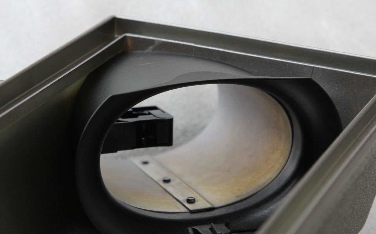

1) The difference is the ratings. The 2011 engine was rated 386kw, which is 518hp (SAE), or 525ps (metric). HP and PS are not the same. More info here:
https://www.carwow.co.uk/guides/glos...-is-horsepower
2a) I don't know why Pelican was talking about an aftermarket intake, when you specifically asked about the ROW (i.e., non-USA) factory airboxes. The difference, besides the missing carbon filter, is the shape of the pipe internally. The ROW plastic snorkel inside has less restriction because it was not flattened to make room for the carbon filter. Google for photos showing each type.
2b) You'll get near zero power gain with any aftermarket filters, regardless of what anyone claims, but your wallet will be lighter. The ROW airboxes may provide a small power gain but it's likely in single digits. If you are shelling out for a "tune", the ROW airboxes won't hurt, but don't plan on any seat-of-the-pants difference either way. On the bright side, the ROW airboxes include brand new airflow sensors so on a higher-mile engine, that alone may be worth the cost.

USA airbox with carbon filter removed:
