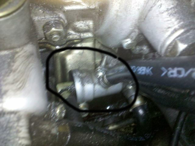

Do you still have this kit listed on ebay? I am attaching a photo of my leaky part which I think is the Diesel Fuel Thermostat you are speaking of...
Chris

That is exactly whats leaking on your car in the picture. I don't have any more of the kits in stock, but I can put one together for you if you can wait a week for me to get the parts + however long it takes to ship to you from PA. Let me know, you can email me directly at: Devicefuljake@gmail.com
