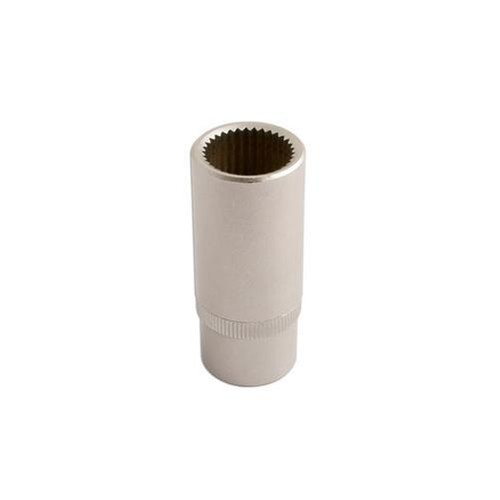

I have a '96 E300D that I'm restoring to get roadworthy again and I've discovered a fuel leak at the top of the pump at the injector lines. It seems to seep right at the base of the injector line connectors that look like a fine-toothed gear. My question is how I can remove these connectors? Is there a special tool I have to get? Are there replaceable seals inside or do I just have to tighten them up maybe? See attached picture.

Wow, old thread. If the fuel injection pump mentioned is on a Mercedes care this is the tool: Laser Tools Fuel Injection Pump Socket 5471. This is a copy of the Hazat tool which is way expensive.
They are sold on eBay and also used to be sold on Amazon.
The kit is O-rings and some copper-colored washers. I would look for those on eBay.
I don't know if instructions how to do it are here on this forum, but I am sure benzworld.org and peachparts.com has instructions. However, the first threads you need to go to are the ones were people had problems. Also, the torque is in inch pounds/pound inches not the typical foot pounds/pounds foot.

You need a special Bosch delivery valve socket to remove those fittings. Inside are a sealing washer and O-ring that should be replaced to stop the leak, tightening alone won’t fix it.
