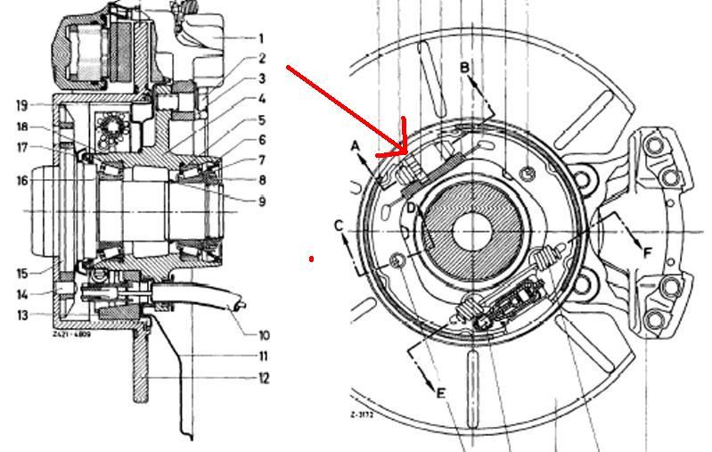

i have an all wheel disc model and i cant seem to figure out how to re-tension the wire running to the rear calipers, if theres a diy please point me there.

the tensioner has no more room left in it... so i was wondering how thick are the new shoes?

They could indeed be worn out.
There is also a Star type Brake adjuster (like on the Drum type Brakes) for the Parking Brake shoes that is accessed by way of a hole in the rear Hub.
