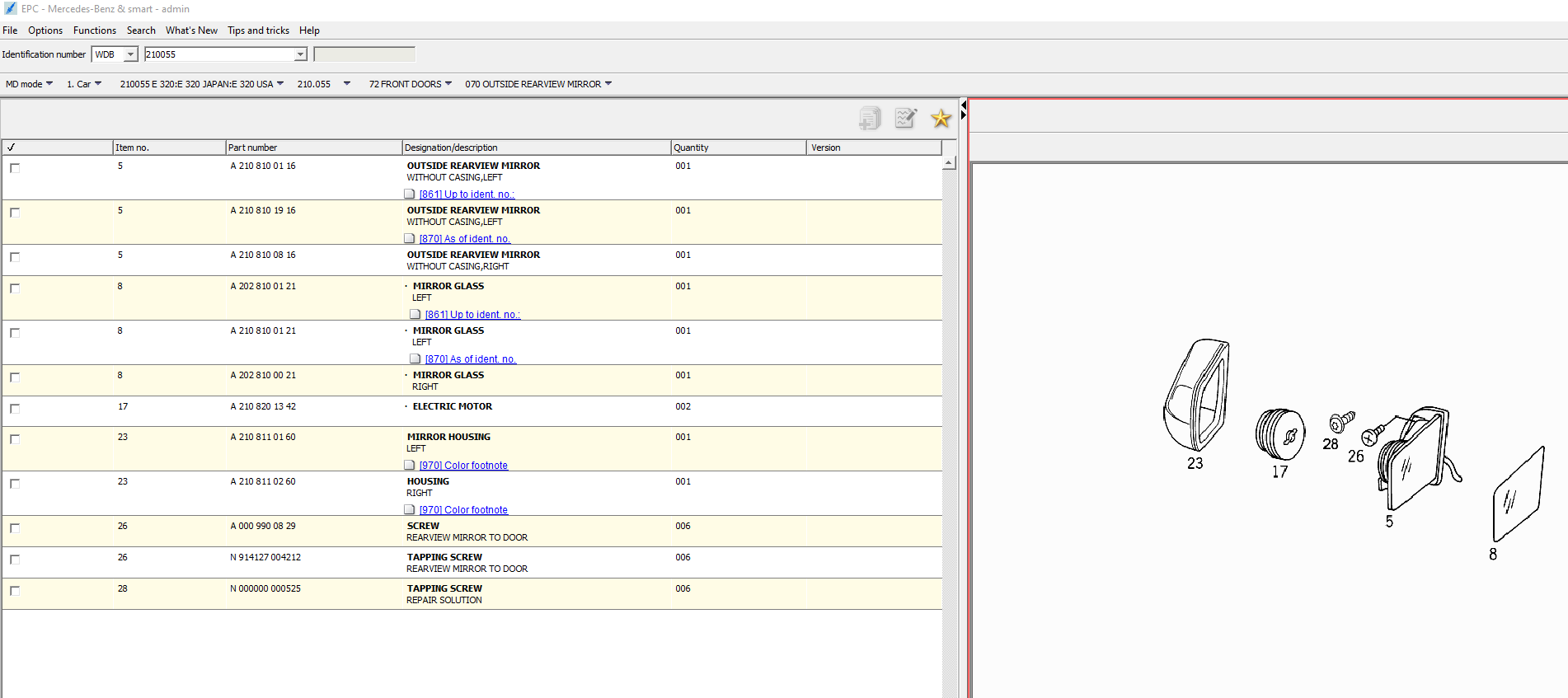

Hello: I am looking for two body parts for my '96 E320 Wagon that are damaged. They are #2038105076 and #2038201421. They are the mounting bracket and clear lens for the passenger side mirror.
None of my usual part outlets can find them. Any suggestions out there?

Andrew, where did you get those part numbers? They are for the 211 and some other chassis, not the 210 chassis.
Your 1996 E320 should use mirror assembly A2108100816 which includes mirror glass A2028100021 (but, does not include the painted plastic cover). Unfortunately both of those parts are discontinued / NLA from the dealer, so you'll likely need to get good used ones on eBay, or a local salvage yard.
EPC screenshot below for the 1996 E320.
I don't think there was an E320 wagon sold in USA for 1996 model year... is your car USA spec?
