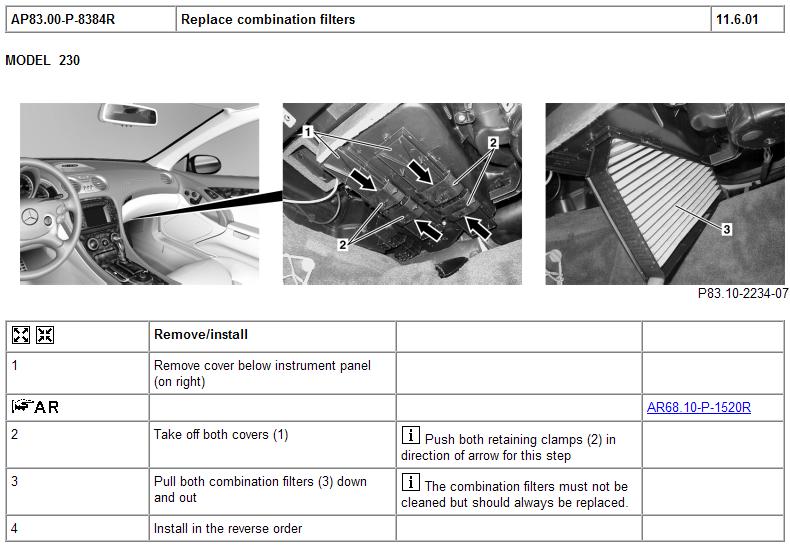

We purchased a used 2006 SL500 in May of this year. The cars interior has a smell. I think it's most noticeable when the A/C is on. I asked the previous owners, who also bought it used, if they know what the smell is. They said the Mercedes Dealer they bought it from must have done something to make it smell. It smells like an air freshener or like someone spilt a bunch of perfume inside the car. I've used a spray that is suppose to eliminate smells and it might have helped a little, but the smell is still strong.
In doing some searches in this Mercedes Forum I kept seeing postings about filters including some about carbon filters. Thinking, if it's some type of air freshener, it might be placed in the filter compartment. This leads me to the questions:
How many filters are there in the climate control system?
Where are they located?
Are there any tips on how to get them out?
Any help with this would be greatly appreciated.

The attached screenshot is from the R230 Tech DVD available for purchase directly from MBUSA. It only costs about $50 and is highly recommended. Call 1-800-FOR-MERC.

Great picture. Someone at another Mercedes Forum gave me a similar picture, but not as good as yours.
Also, I'm going to checkout the tech disc you wrote about.
