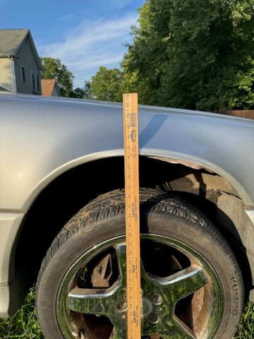

Had my alternator replaced at the local garage(non-Mercedes). After getting my car back, I noticed the height in front of the car was way high. The mile drive home was rock hard, felt every bump to say the least. When I got home, I opened the hood, and the suspension reservoir was empty. I then went online and ordered some FEBI-ZM. I filled the reservoir while running the car and there was no change in the front height of the car. I then ran the reservoir return line into a bucket to check the pump, appearing to work fine. The rear of the car appears to be fine. So, of course I have questions:
  • Could they have disconnected something while replacing the alternator?
  • Did my Nitro spheres get filled with air from lack of fluid?
  • Reading a lot about height linkage near the passenger side -- can be adjusted for ride height. Could this be the issue; maybe they disconnected it and hooked it back up in the wrong position?
I have been reading the forums for the past 2 months. Most ADS2 issues talk about suspension being too low. I have experienced that side of it already. Nothing I am reading speaks about the height being too high and rock hard. You feel every bump. New Nitro ***** were put in about 10 years ago by dealer. Suspension was working fine prior to alternator replacement. The local garage has offered to help me out; but I need to know what things to look for when it’s up on the lift. No leaks that I can see either. You can see by pictures and the ruler how high it is.
These are my challenges. Any thoughts, suggestions, and assistance would be greatly appreciated. Thanks in advance.
