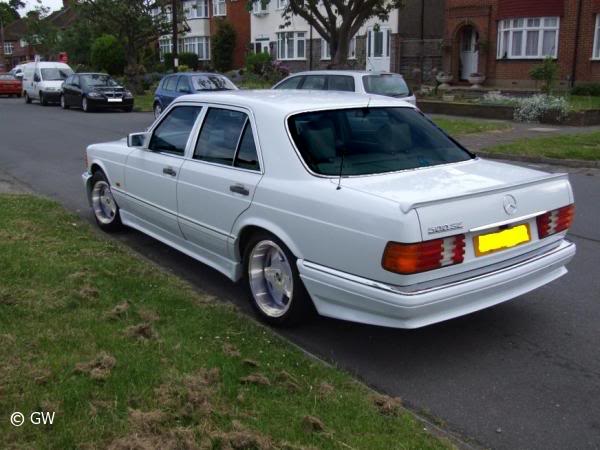

I have decided to go for 225/55/16, which is a difference of diameter of 0.2 which would make it 25.7! So thats as close as ya ganna get i reckon!
So happy with that, just hoping the 225/55/16 will fit on the fronts as im ganna go with that size all around. Tyre company said they should do?
She should look somthing like this when done:
