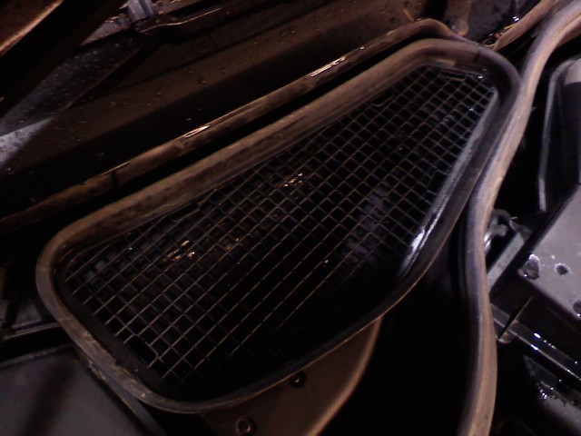

also check under the hood, under the windshield and look into the water catcher grate and see if there is water in there or debris....if there is water in there...stay away. deris gets into there and clogs up the drain, then the water backs up and flows into the car onto the blower motor, shorting it out then getting all the carpet wet and running back to the rear fuse box and getting it wet and causing HUGE issues. there are numerous control units and other things under the carpet that get water damaged. overall a great car just is usually better if it has been serviced at a dealer since they do know your car better than anyone else will. good luck!
