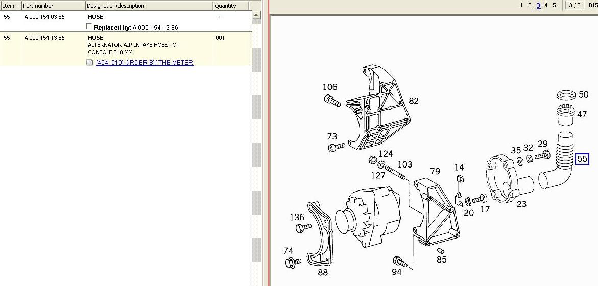

Thanks. Doesn't seem to be a required part but makes sense, especially considering that this car had a partial belly pan for aerodynamics once upon a time. With your information I googled and found this
