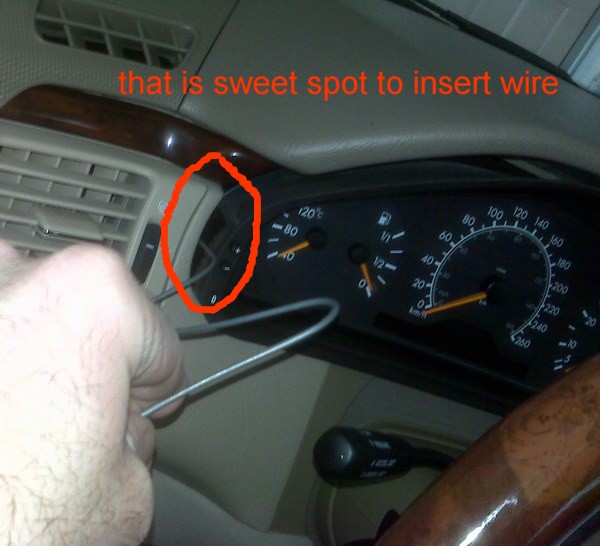

The cluster requires a pair of 'pulling hooks'. They are inserted at the left and right corners (between the dash and cluster) near the "+/-" buttons and the "h/m" buttons. The cluster is a friction fit. It is worked out by pulling a little on the left then on the right and repeating.
If you remove the fabric panel under the steering wheel, you can push from the back as well. If it has been in place for a long time it can be hard to move but there are no bolts/screws holding it in place.

Thank you Richard for fast reply so those hookc could be made of wires i guess and some good handle to pull .I am glad there was no screws.

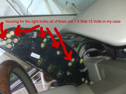

ok here is what I have found.
all bulbs on the back in my benz are 1.5W 12 volts made by OSRAM.
cost at dealer is 4.99 each at NAPA you can find 2.89 each just different manufacture.

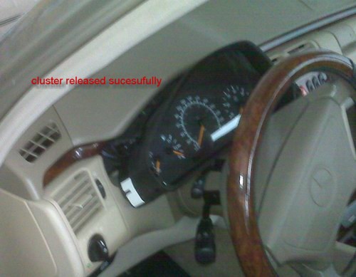

Removing the instrument cluster was such a fun.I was using two pieces of steel wire as you can see on the pictures.It was hard at begining you have to find best spot to pray wire and pull.I did first right side than left.There is two rubber thing on top and two on the buttom which are holding cluster to be in place.Now when it is removed good idea will be to lubricate them just in case for the future to remove it easy.
To remove bulb use flat scredriver and twist 90 deg and bulb will pop out.
I had two bulbs to replace one for the temp.gauge and second one was for high beam.

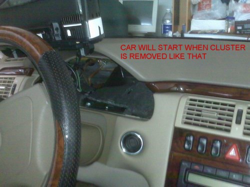

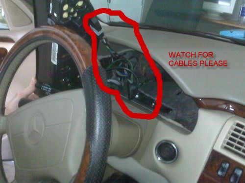

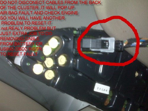

This is part on of pictures in order how to remove cluster on e320
1999
part 2 next
Attached Thumbnails how to replace bulb on cluster panel-e320-1999-cluster-1.jpg   how to replace bulb on cluster panel-e320-1999-cluster-2.jpg   how to replace bulb on cluster panel-e320-1999-cluster-3.jpg   how to replace bulb on cluster panel-e320-1999-cluster-4.jpg   how to replace bulb on cluster panel-e320-1999-cluster-5.jpg

part 2 with pictures
Attached Thumbnails how to replace bulb on cluster panel-e320-1999-cluster-6.jpg   how to replace bulb on cluster panel-e320-1999-cluster-7.jpg   how to replace bulb on cluster panel-e320-1999-cluster-8.jpg   how to replace bulb on cluster panel-e320-1999-cluster-9.jpg   how to replace bulb on cluster panel-e320-1999-cluster-10.jpg

if you try to start car with cluster removed like so it will be possible car can run but if you disconect cluster than car will run too but not sure if it will be adding miles on odometar or not.
It is possible to get warning light for air bag if cables are disconected.
Removing power from both bateries will cancel fault.
Use flat screwdriver to remove light bulb,just twisted 90 deg and it will pop out.
do not use bulbs more than 1.5 wat 12 volt. it can overheat instrument cluster,
