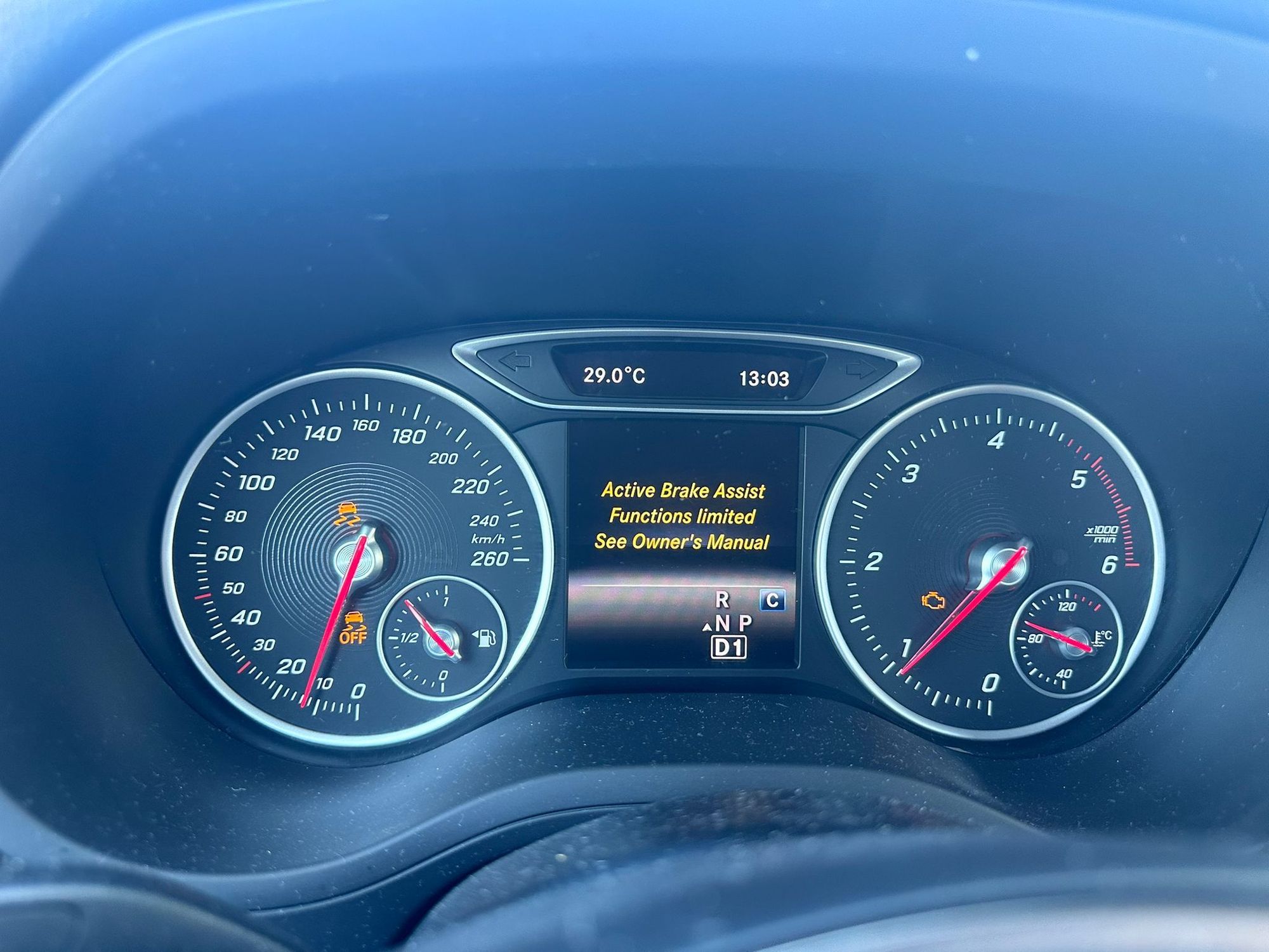

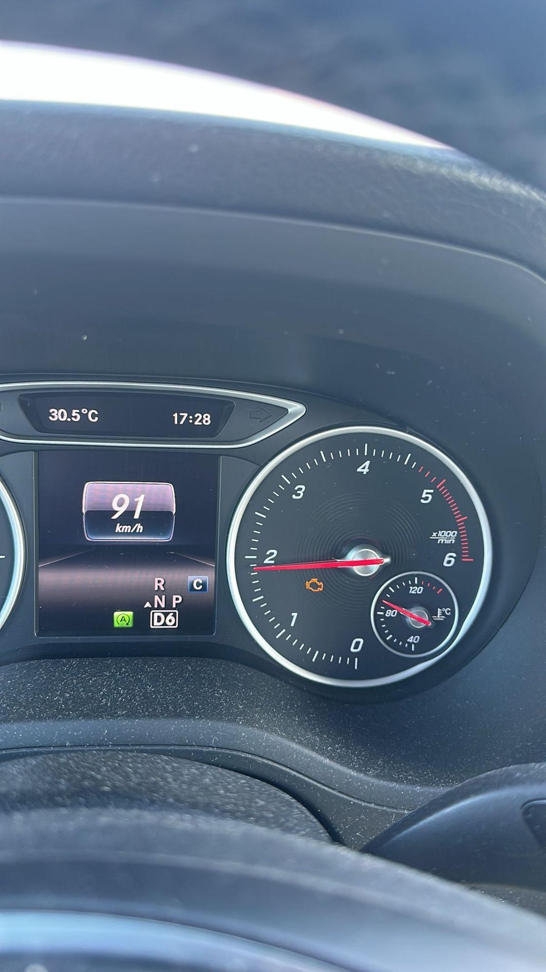

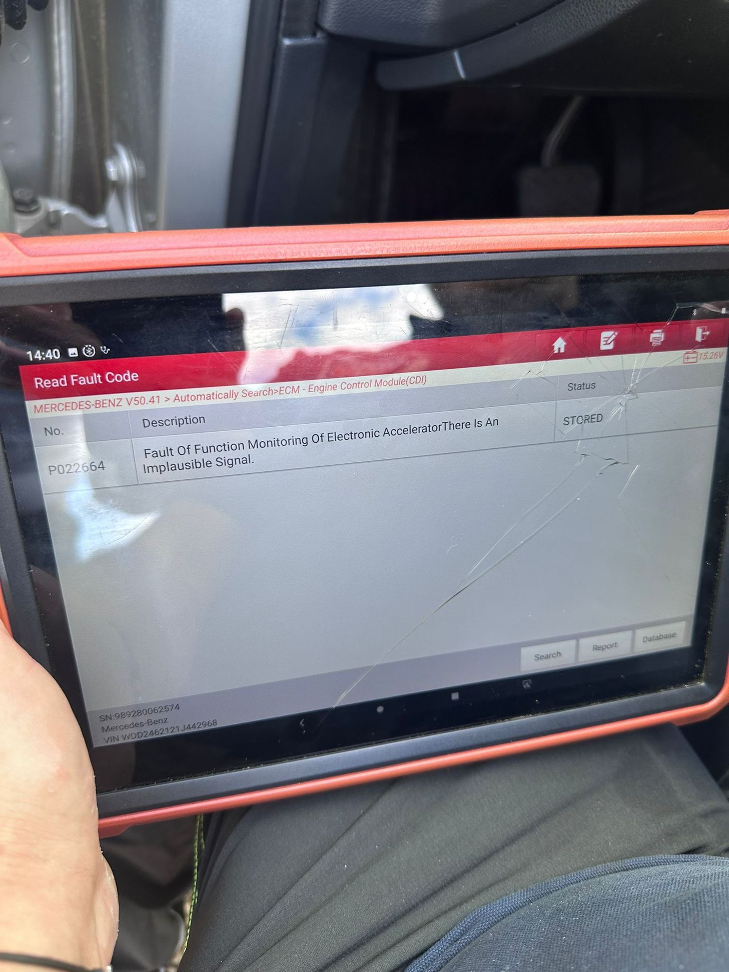

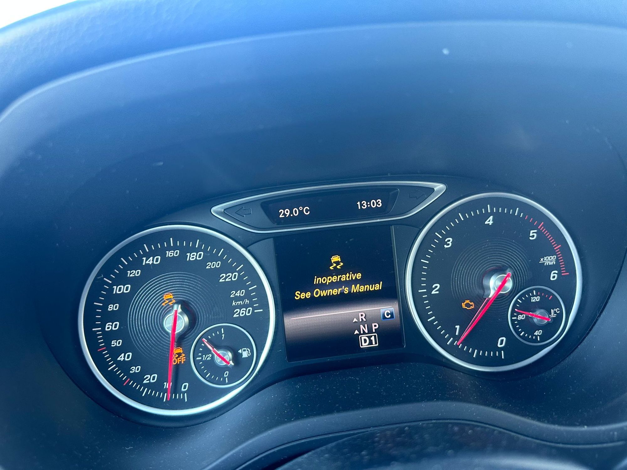

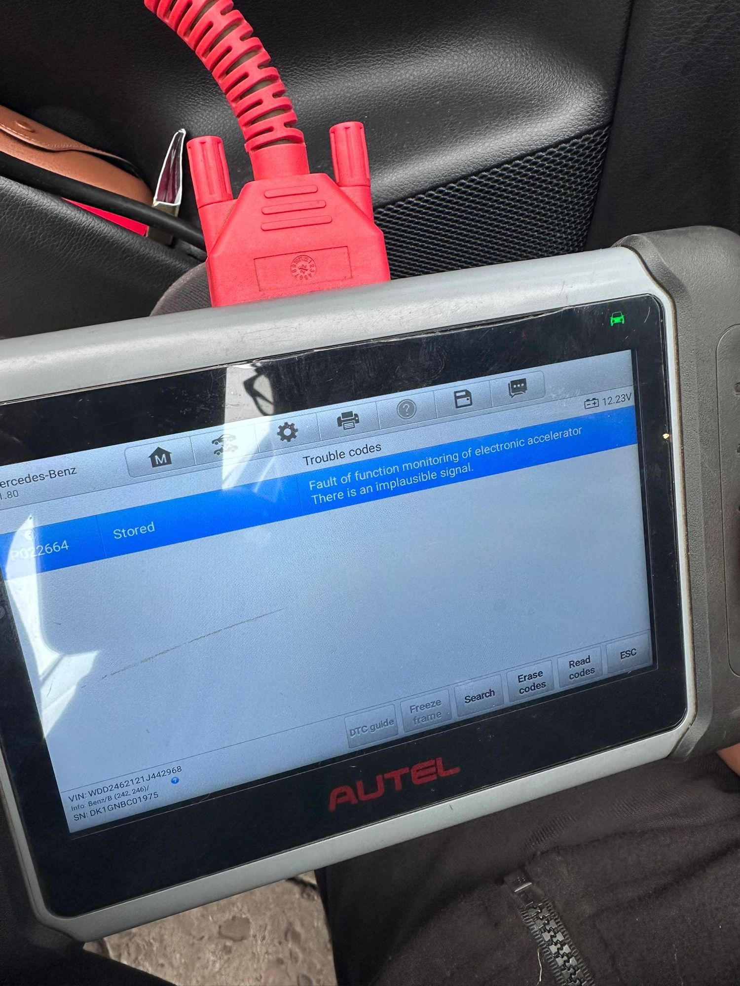

Hello everyone.
I’m facing a problem and I’m at a loss for solutions. It seems like nobody else knows either.
Every so often I encounter the error mentioned in the title and the car goes into limp mode. If I stop the car, open the door, lock it and perhaps reset the CPU, the limp mode will stop.

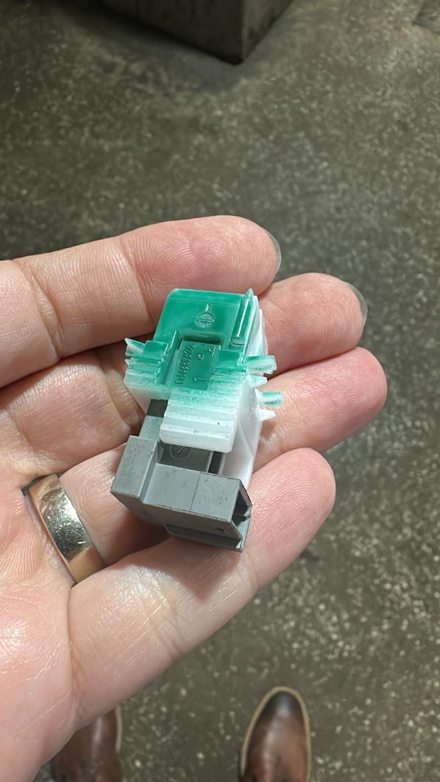

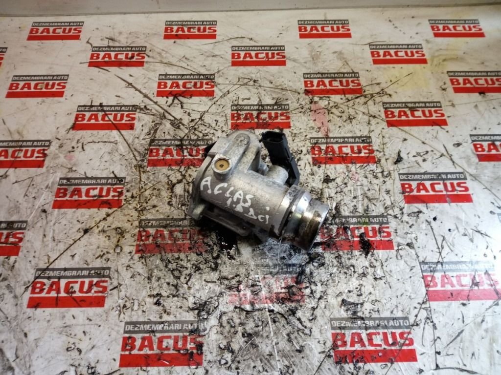

I’ve already changed two acceleration pedals, checked the electrical wires, swapped the connectors on the pedals, the brake pedal commuter and the admission clapper on the engine. I’m at a loss for what else I could try.
he car is a B class from 2017, 1,5 DCI, B180D
Thank you all
