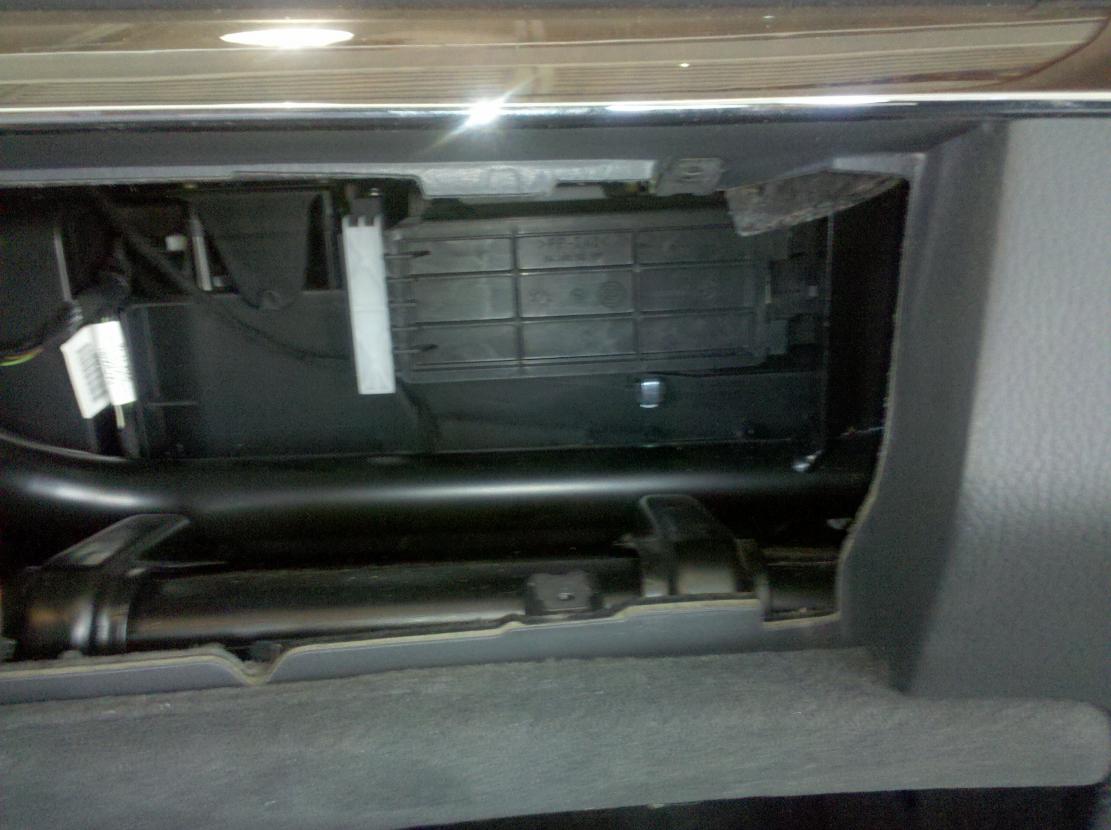

remove the glove box. open glove box, 2 phillips screws on the bottom covered by rubber caps, and 2 at the top...no caps, pull out glove box leave cable attached for latch, youll see the cabin filter box slide up the plastic white clip and remove the access door. slide out filters
Attached Thumbnails help needed is changing air filters on 2004 cl 600-cabin-fliter.jpg
