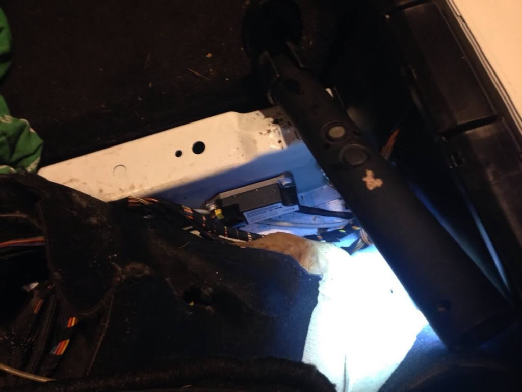

Just picked up a 1998 C43 for a good price, but it's got some issues! Oil leaks, drive shaft bearing, small rust spots,and my main concern is the SRS light is on! I ran the codes and it came back 033 passenger airbag sensor no communication (A54)! Is anyone familiar with this code, that could Give me a starting point to hunt the problem down.
Thanks Jim

Airbag impact sensor under the carpet under the seat, looked like something spilled down there. $500 at the dealer, but I found a used one on ebay for $40 different car but same part number worked fine!
