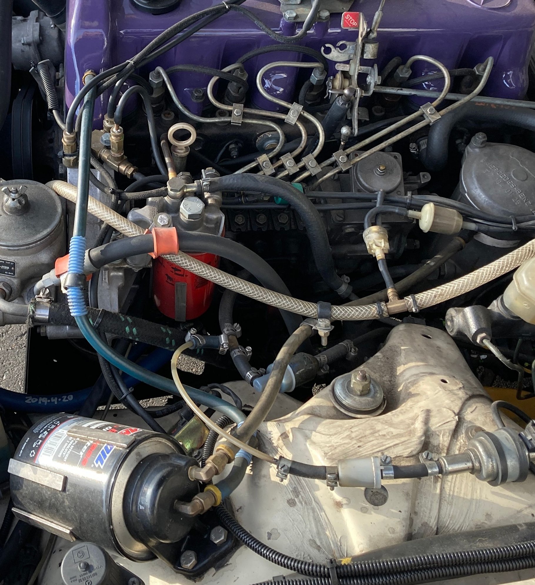

I have a 84 300D. I installed my own bypass oil filter system, and the major problems were where to get the pressurized oil from and how to get the oil back into the crank case.
I tried various means and ended up with pulling off the oil filter cap and the long tube simply pulls out of it. From inside of the cap I used the proper drill bit for an 1/8th inch pipe tap. I drilled in the center of the cap and to another hole near the outer inside edge of the cap between the casting webs.
I tapped it from the outside and installed 1/8 inch fittings.
What you have to remember is that the metal is thin. You don't want to over tighten and strip or worse split the metal. I put JB Weld epoxy on the threads and just snugged them down and let the epoxy do the sealing.
The one on the outer edge of the cap was the oil pressure feed and the one going down into the center of the cap was the oil return line. The oil that goes down the center of the cap and that long tube goes back to the crankcase.
Drill+tap the oil filter housing. Use a JIC fitting tapped into the valve cover.
Added bonus the extra super clean oil lubricating the chain directly.
