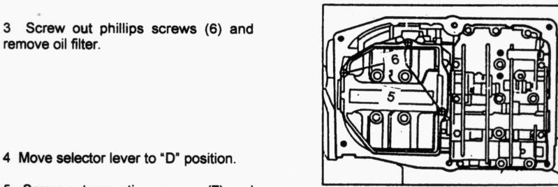

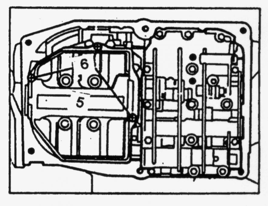

see thumbnails #6 is pointing to 3 Phillips Head Screws
I was thinking of getting a rebuilt tranny from a recently damaged 81 300D. Then again, I did drop the pan after a week it was nice and clean.
I have a non turbo tranny so the pan is smaller and the filter has 2 philips screws to hold it in place. So far things are normal. Thanks for your input.
