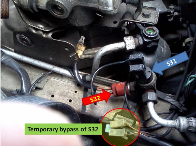

Thanks for the Wiring diagram of my 93 300d A/C. The diagram shows two pressure switches: S31 & S32. I have other documentation which shows me the location of all the other A/C components, but I can't find the pressure switches. Can you help again?

Musicmaniac, in my 92 300D the switches are next to the receiver dryer bottle glass window where you can check for bubbles in the system. The top one is S31 and the bottom one (red) is S32. Here is a picture. I hope it helps.
I looked at my 93 and it looks nothing like your picture. A few days ago I took it on a long drive on the interstate (about 1 hr) it practically froze me out (45 degree air coming in always - with 80 degree ambient). Before I started, I noticed that neither of my AC fans were on. Do you know what would prevent BOTH from coming on. Obviously the compressor clutch was pulled in because the air was working. I think it must be something in the fan circuit.

Thanks to your picture, I finally located S31 and S32 (a little different location from your 92). In your picture you labeled a temporary bypass of S32. What is this used for (anything labeled temporary makes me think it would only be for testing)?

Ok, I'm glad you located them. When I said temporary, I meant that I was going to leave it bridged until the time the refrigerant leaks out of the system and at that point replace the S32. I just did not want to waste the charge. So far, the system seems to be holding the charge very well so my "temporary" may stay there for a while :-). Another thing you need to be alert is that sometimes the overload relay (the one with a red fuse on the top) may get loose or the connections that come to it may be loose and that will shut the compressor off. Fortunately, the main symptom is that you will loose RPM indication. The needle will just stay at 0 RPMs or sometimes erratic. I hope these tips help your son stay cool. Good luck.

1) What kind of material did you use to bypass S31?
2) If you read my earlier post you see that the A/C works fine at Highway speeds. That indicates to me that the fans are not working. Do you think a bypass would fix this problem? The MBZ shop told me that the RPM indication is the problem (and they wanted $1200 to replace the compressor).
