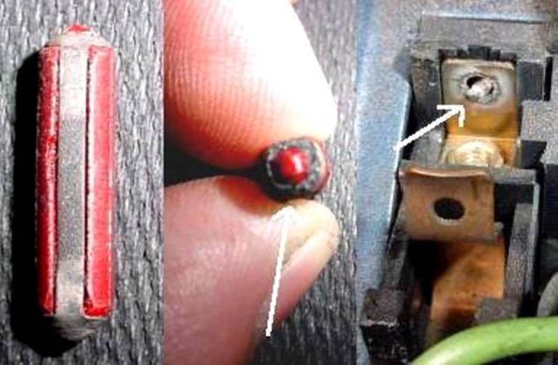

I forgot to say what I do is when I go to the Junk Yard I take a Zip Lock Bag with me and I pull a bunch of good fuses in the amperages I need.
When I use them I make sure the Fuse tips are in good condition and wire brush them to freshen them up.
I also clean the Brass contacts where the Fuses attach.
In the pic below you see why 2 of my Windows stopped working.
