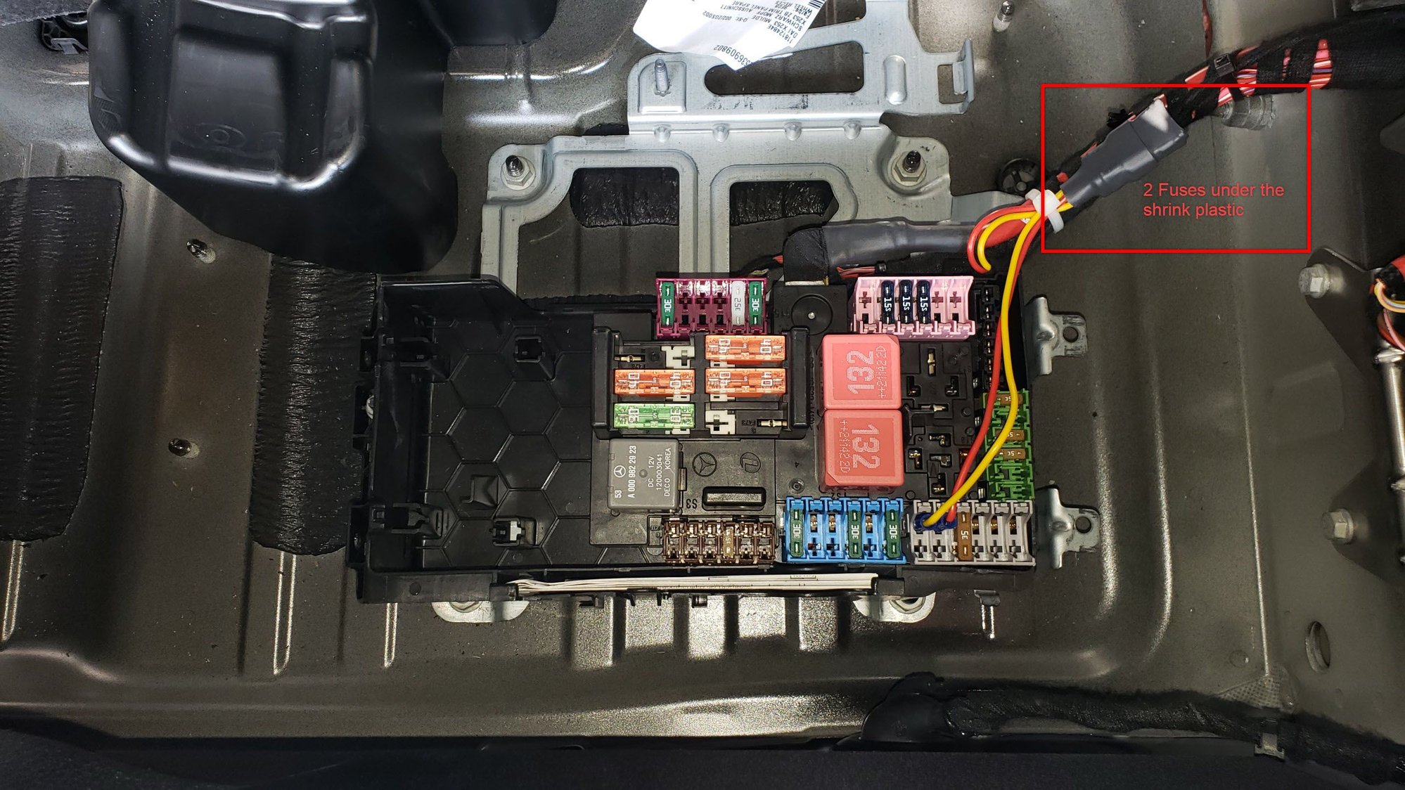

- Changed the fuse location. No impact.
- Looked at the ground but I didn’t see one the way they installed it. The fuses are not directly in the fuse box in the trunk, there is a wire coming out of one end of the fuse and into the fuse box. Essentially just extending the fuse. It shouldn’t make a difference. The other end of the fuse goes back to the unit. So it's kind of inline.
