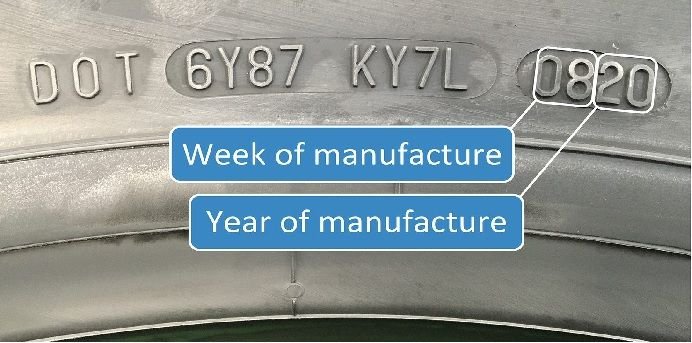

Last thing: if you buy used tires (assumingly because you're desperate) ALWAYS check the DOT number on the sidewall of the tires!!! The last 4 numbers are the only ones that matter for you. The first 2 numbers are the week of the year, and the last two numbers is the year. i.e. 0820 is the 8th week of 2020. see attached picture. Never buy tires older than 5 years.
Last 4 digits of DOT number indicates age
