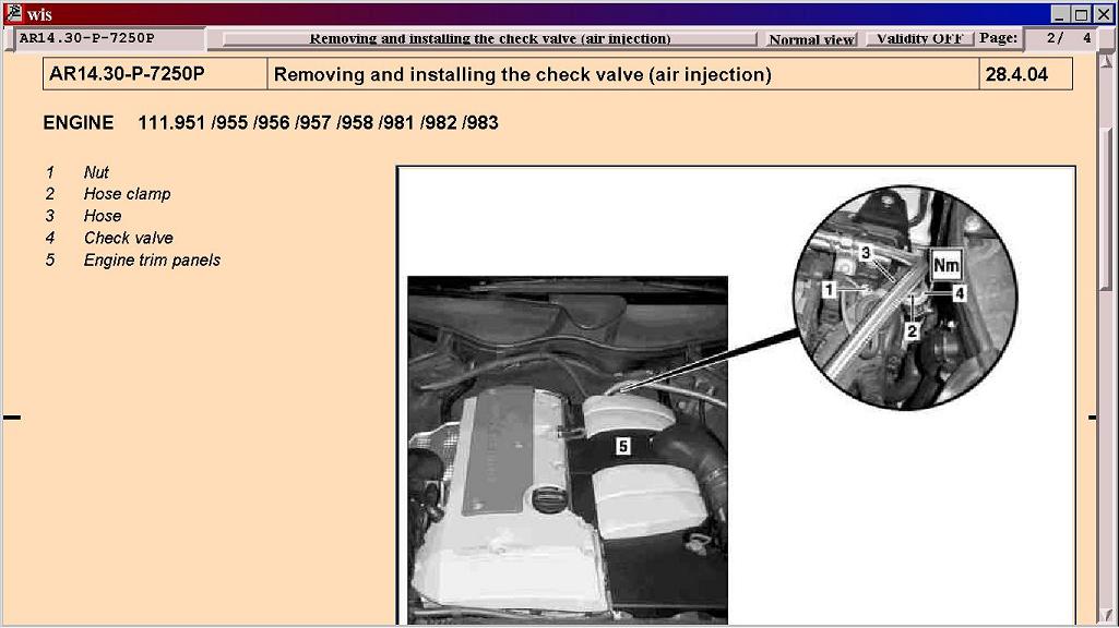

OK so here is the question Max - i purchased the new check valve part from MB and I couldn't install this for the life of me. I just spent 10Hours trying to get the old one off - PLEASE PLEASE PLEASE someone help me. I have read that its a 27mm crowfoot wrench - which no one seems to have at all so I cut down a 27mm jet wrench to try and get it off and it seemed that it just would not fit at all. I tried wd40 on it to loosens it. NOPE nothing. Tried heating it NO nothing. I just can't get my old one off and yes it was rusty inside just as people had described. I also tried grabbing the top of it with lock pliers and then turning the lock pliers - I nearly damaged the top and ripped it off. WOW was i ever frustrated.
PLEASE SOMEONE HELP ME - HOW DO YOU GET THE CHECK VALVE OFF OF MY CAR its located in the back of the engine and its a bitch to get off. NO I MEAN ITS BRUTAL - you have no spanner room to take it off at all. Can someone post pics or a link to pics on how to take it off. I will pay someone - I just can't get this thing off at all HELLLLP.

After reading through a LOT of posts about this error code I decided to try and replace the check valve (air injection) on my 02 c230 coupe. Dealerships were giving me part prices of anything from $75 to $120 so I said screw that and removed the check valve myself (VERY EASY with 10mm socket and pliers!).
After testing the valve by oral vacuum (lol aka my mouth) turns out the thing was clogged and would not open under any amount of sucking on the inlet/outlet for the smallest air tube. Sprayed some carb shoke cleaner into it and kept working it until it finally popped open. Then I let all my saliva/cleaner drip out before reinstalling exactly as i removed it. Besides a bitch of a time with the hose clamp it saved me the trip to the dealership all together. i know this code can be many many other issues but i figured i'd throw my two cents in.
Cleared the code and over 250 miles later still no engine light. I am concerned about all the S/C power loss issues im reading about but I can't really tell if i'm suffering from this or not (car still pulls fine up hill with four people in the car) also get the WIS dvd manual because it will save you countless hours and dollars. Love the car, hate the dealers and mechanics.
