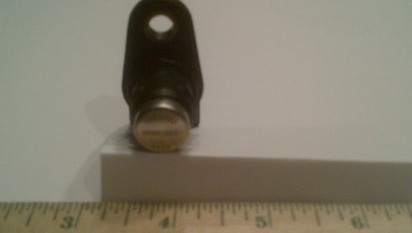

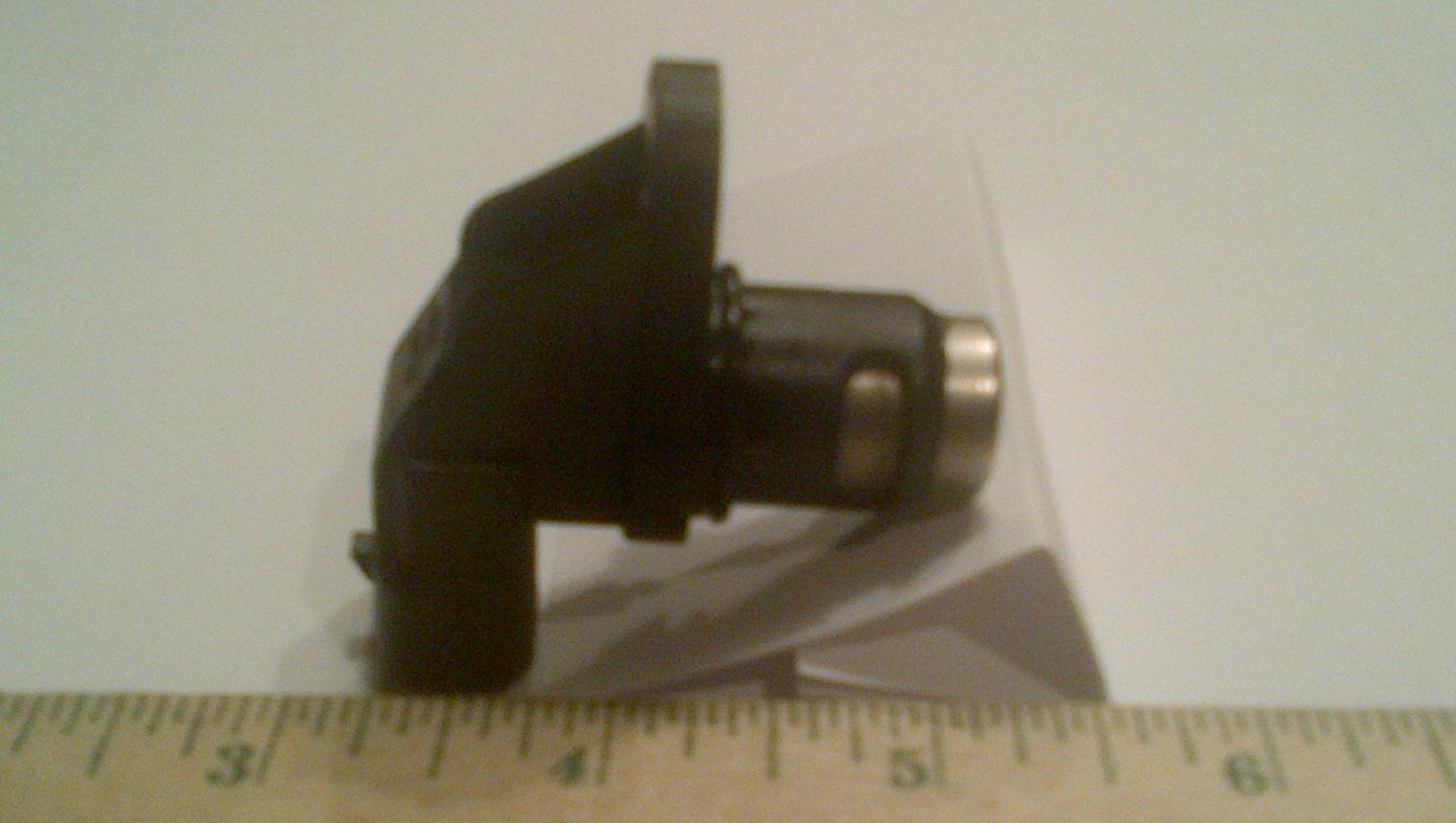

Just got my wife's car back today. Serviced by Mercedes South Atlanta.
Report States: Check Engine Light is on. Drives the same.
MB: 152148 Camshaft Hall Sensor - Ignition Syst., Replaced
Notes: 14694 Cam sensor 2.00 Checked codes with SDS found code-200B
Cam Hall Sensor Nec. to test and replace Cam Hall sensor and test drove with several key cycles all ok at this time done.
Part No. 004-153-69-28
Nomenclature: Sender Unit
Parts: $212.10
Labor: $241.56
Total w/tax: $507.28
Attached is the Camshaft Hall sensor that was replaced.
