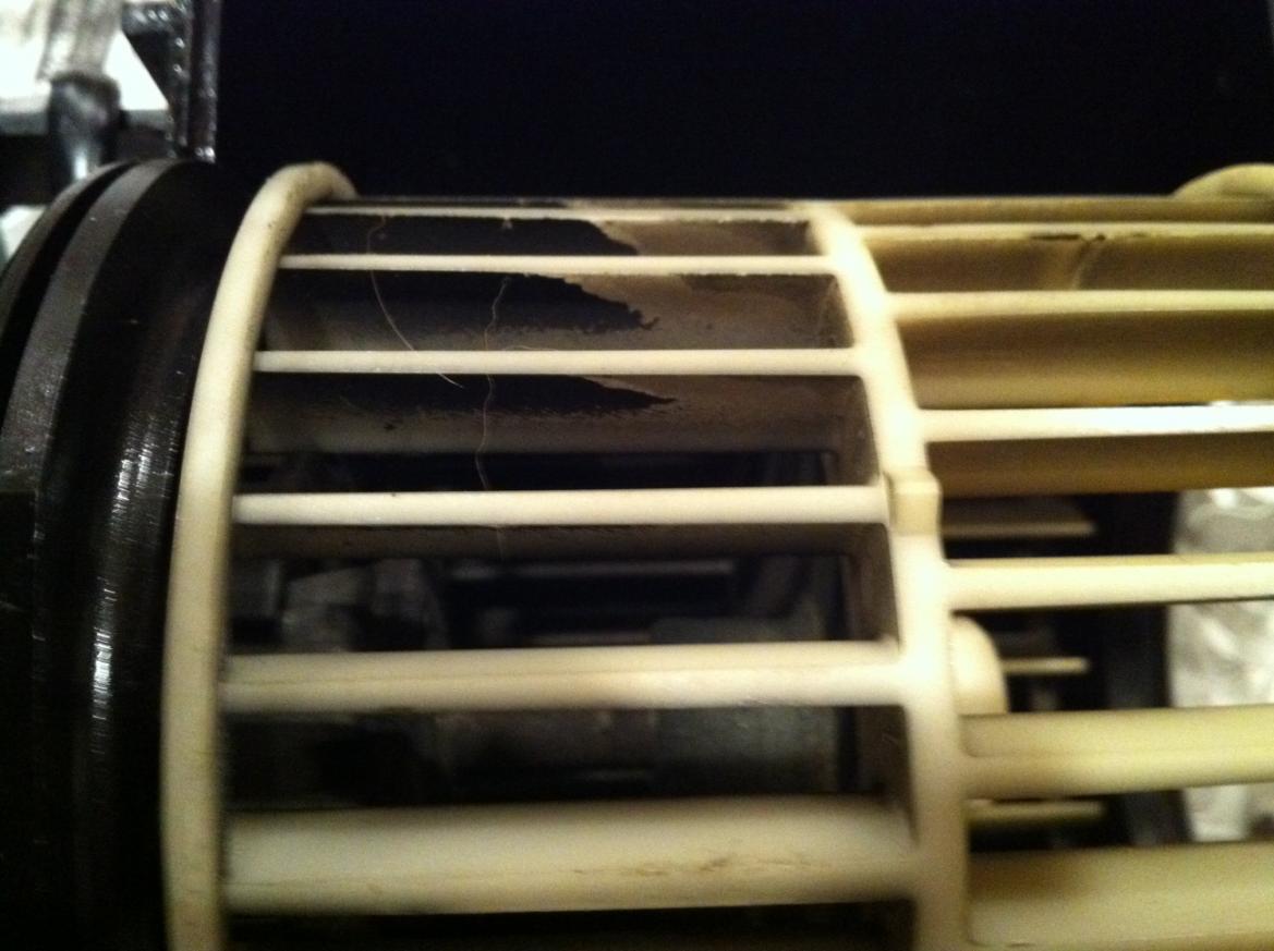

Old Oct 4, 2011 | 04:14 AM
  #10
MBSL560's Avatar
Joined: Sep 2011
Posts: 26
From: Japan
hi sun guy
I have managed to get the blower motor out of the car :-)
just cleaned it up on my dining table :-)
I will put it back tomorrow and will let it run for a while to see if it is still squeeling. I took a picture to show you the brushes. I guess you mean the two white plastic ones :-)
Can you see the "black" spots there? Does this mean that it is time to change them or soon? You told me you sell them or can tell me where to order them? I can easily remove them for replacing? Did not see that fast how to remove them... :-)
Would be nice if this will be a cheaper way to solve the problem also as I do not really trust my mechanics anymore. I have paid thousands and still I have problems. The car starts to shake again. Not so bad, but still. It anoys me. I paid for it a lot such transmission and new cylinder (like 1500 dollar).
AND by the way. When cleaning the blower motor I played with the brushes. The squeezing noise I hear when using the blower motor is such sounding like if the brushes are working against the plastic cover. I heard it a when I turned them.
thanks
