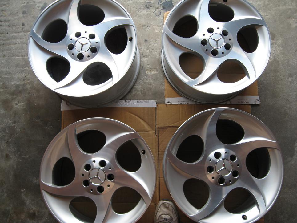

I recently purchased a 1998 SL500 (non-Sport) and I absolutely love it! However, I am looking to make some changes and I am starting with the wheels. Today I purchased a set of 'Alphard' wheels for an awesome price, (photo posted) off a newer model SL and I am about to order tires. I have seen pictures of these wheels on an R129, but I'm not sure if they needed spacers or new lug bolts, or as I am hearing 'had the fenders rolled?!'

16x8 ET34 (225/55-16)
Alphards front/rear:
18x8.5 ET35 (245/40-18) or (245/45-18)
18x9.5 ET40 (275/35-18) or (275/40-18)
Do I need spacers, lug bolts? If so, what size and where do I purchase them?
I have used the offset calculators and it seems they may sit in a bit far and I'm worried they may rub. I have read and read so much and tried so many calculations, I can't think straight! I think I need someone with a fresh set of eyes to help me figure this out. Any help would be greatly appreciated as I am waiting to purchase tires until everything is sorted!

the tire dealers are pretty good at recommending tire to wheel ratios when changing sizes. contact a dealer to see what is needed if anything to put 230 wheels on a 129. your old lugs should be fine.

My biggest concern is if I need a spacer for the rear two tires, because according to the offset calculator, they will be 25mm (one inch) closer to the inside of the chassis. If I do need a spacer, then will I need longer lugs? It just seems every answered question raises another...
Guess I just gotta take a leap of faith and buy tires, then get everything mounted and keep my fingers crossed that it all clears.
