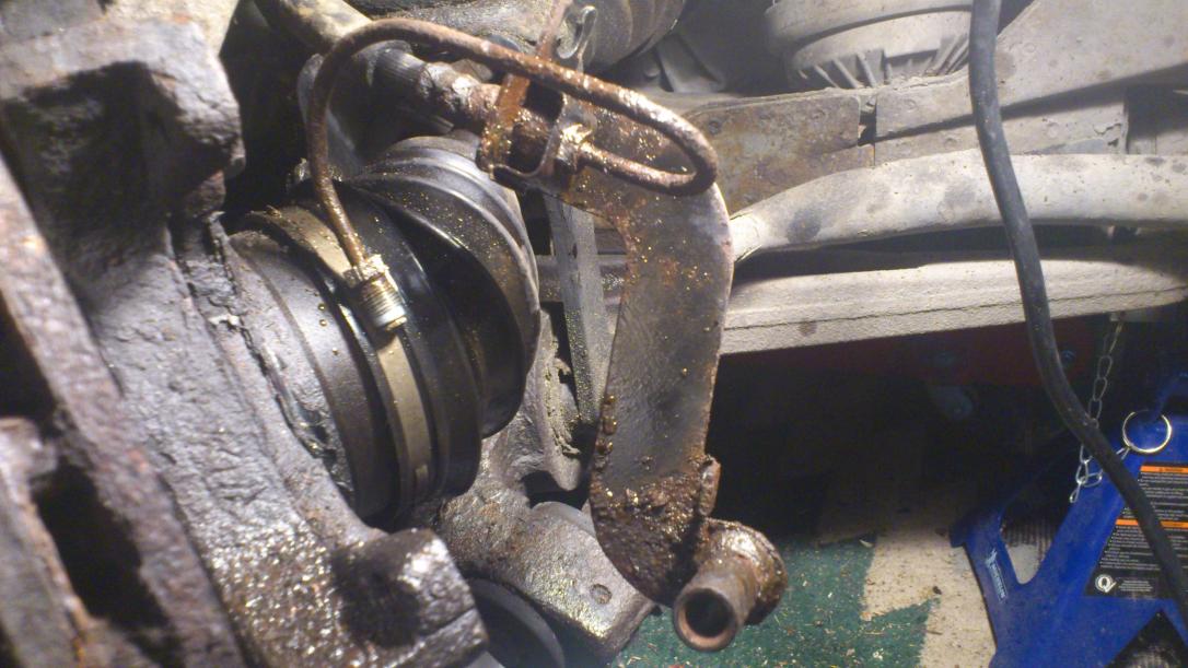

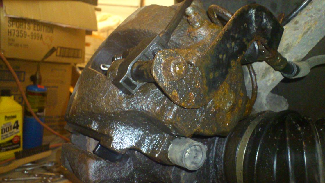

I'm attaching two pics to show what I'm talking about. The first one is a back shot and the second is a top shot. As you can clearly see the caliper inlet line on the top shot and the inlet line mount on the first shot which I can't figure out how to remove, either.
I didn't mark the pics, just uploaded them. But as you all can see in the second pic, the metal inlet line comes from the caliper and connects to the mount and outer hose as shown pretty much dead centre of photo, with outer hose then going "left" of that to connect to inner hose at mount on strut.

OK, after a little bit more work, found that the inlet line mount was actually moving! So I managed to remove the bolt holding the mount to the caliper which hopefully will give me more room to safely remove the inlet line from the mount.

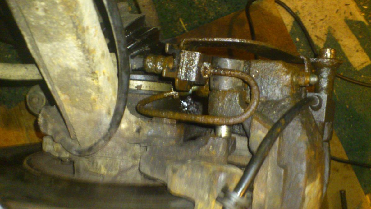

The second pick shows a wider view of the outer hose strut mount and passing through the wheel housing to the caliper inlet.
I think the mount bolt might be a T30 or T40, but it was so badly rounded inside that I just used vice grips to remove it. Thankfully there is a lot of volume on the head of that bolt.
