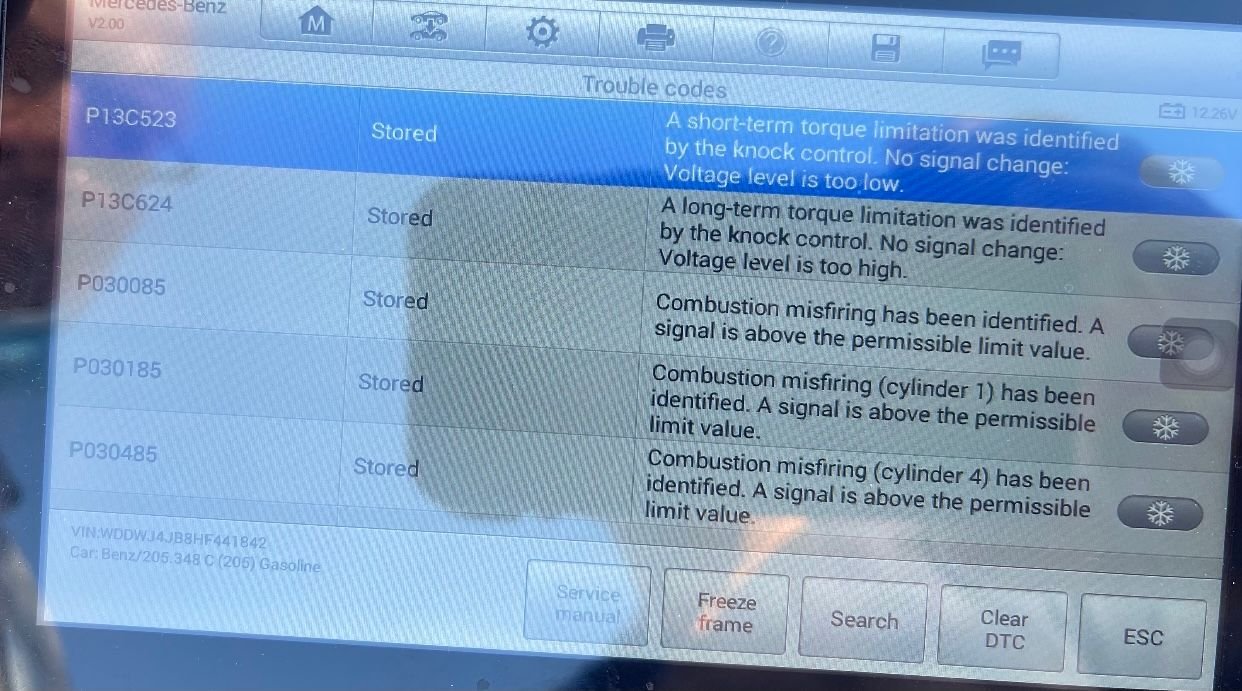

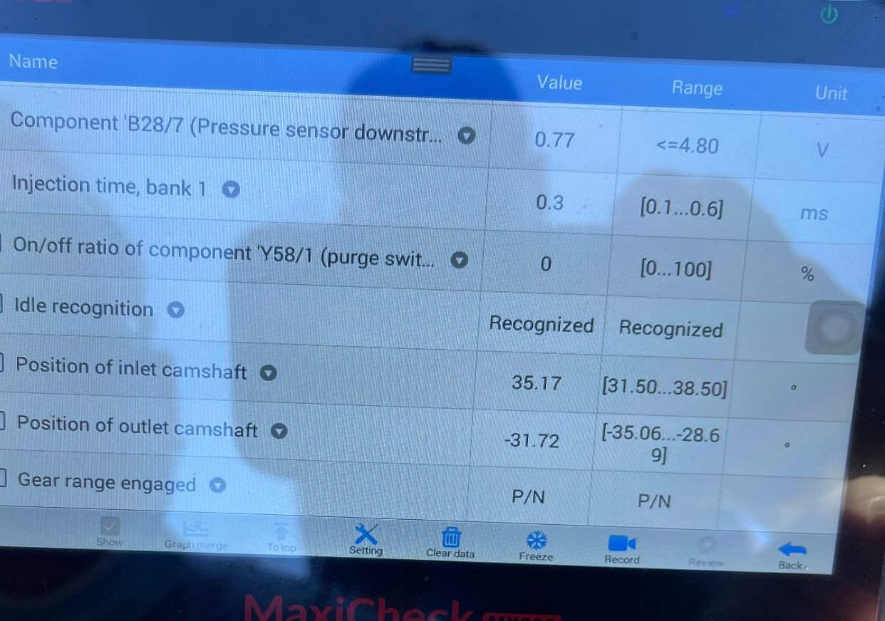

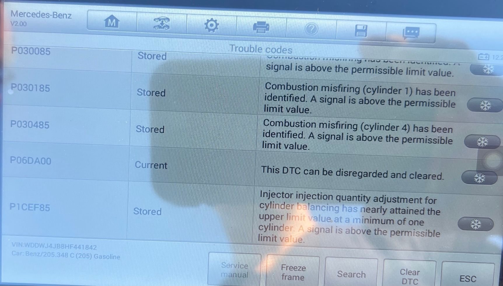

Any information is helpful. I replace the four spark plugs and the coil pack. See picture for new readings
