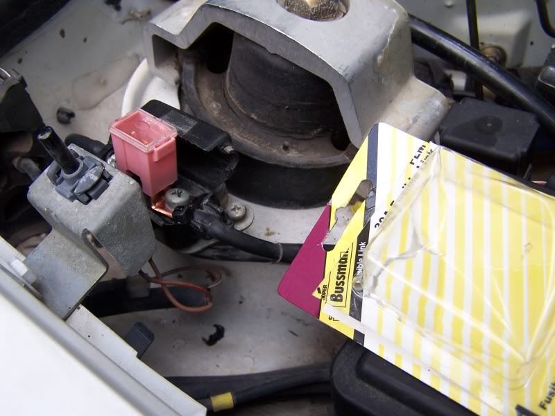

Problem solved. Although the 30 amp fuse "looked" good, it was bad, I replaced it with a 30amp fuseable link I had from a domestic car, and it works.
http://Name:  100_7355.jpg
