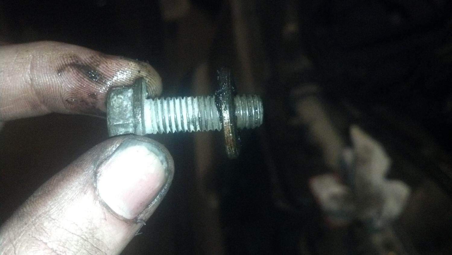

Someone had almost stripped this bolt out that was on the intake..but i def got lucky.Stopped by the hardware store an picked me up some hardened bolts w/wammy washers ...and picked up a boost gauge.I prefer the older style sunpro it matches with cluster better..an it was 18 bucks

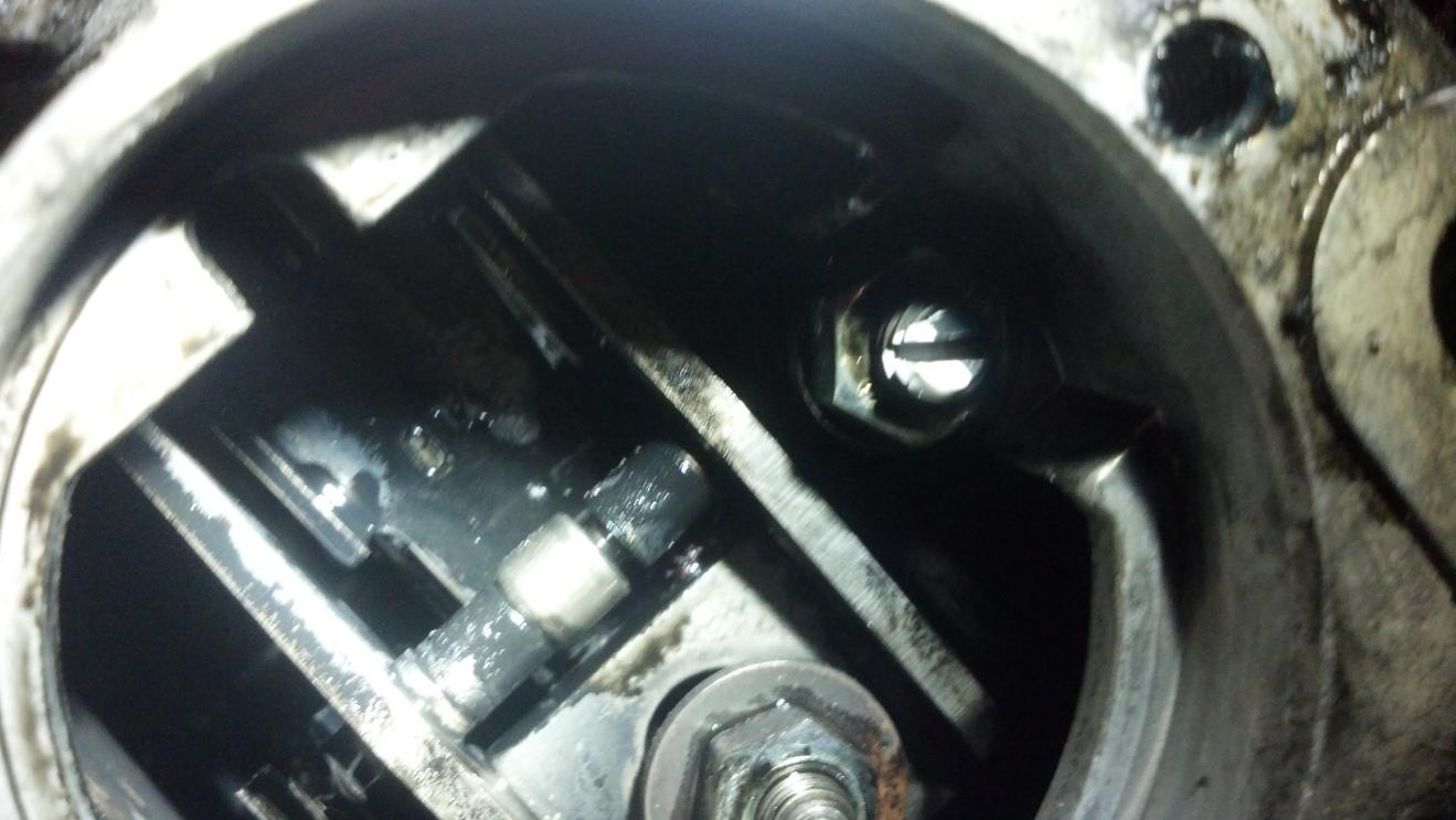

First pic is of the inj pump with the elr an cover removed..2nd is the fuel enrichment adjustment ,3rd is idle adjustment.. i marked both with white paint,there both 10mm nuts an just as forced explained in his how too's above the adjustment screw will move when u tighten down the locknut 10mm ..the white paint will visually assist you better.. btw i turned both 2 full turns cc
