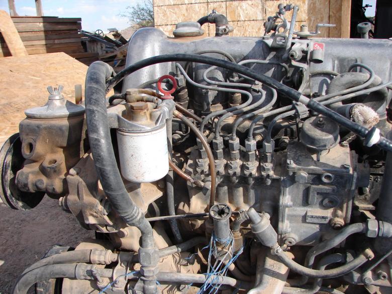

I appreciate the input here. Having never driven or had any association with
anyone with a Mercedes diesel, I don't have any idea of the power range and rpm
limits of these engines. I own a '95 12 valve Dodge Cummins truck and it runs
around 2500 at 70 to 75 mph and around 1800 at 60 so I was using that as a
comparison. Now that I'm getting a little bit of a start here, I need to know
some information on what the various lines and filters and hookups are before I
can think of trying to start it. I took some pictures yesterday and I will post
them and perhaps some of you could tell me what everything's purpose is. I am
especially curious about the round thingy on the front of the engine with two
lines coming out of it. One is a clear plastic one which is broken off about 10
inches above and the other is a black tube/cable/whatever that goes to the back
of the engine. There is also some sort of filter canister at the rear of the
engine and what appears to be a fuel filter at the front mounted on the back of
the power steering pump which I plan on removing {The power steering pump, not
the filter} I will of course remove the A/C compressor and all the lines
associated with it. Also, are the horns protruding from the block on each side
of the engines some sort of motor mount? There are no holes in them but an
indent on the bottom side where they may sit on some sort of protrusion from the
frame. I'm calling them horns for lack of a better word and they are toward the
bottom of the block.
Attached Thumbnails newbie w/5 cyl non turbo for stationary generator-mercedes-pics-003.jpg   newbie w/5 cyl non turbo for stationary generator-mercedes-pics-004.jpg   newbie w/5 cyl non turbo for stationary generator-mercedes-pics-005.jpg   newbie w/5 cyl non turbo for stationary generator-mercedes-pics-006.jpg   newbie w/5 cyl non turbo for stationary generator-mercedes-pics-007.jpg

I didn't realize the Mercedes ran so many rpm's. My Dodge Cummins 12 valve runs a little over 2000 at 70 and I have a diesel bus that runs around 2000 at cruising speed so I was thinking that the Mercedes would probably run in the same range. I will have to rethink my gearing of the pulleys for the alternator to arrive at 3600 to get 60 cycles. I found a Haynes manual for these engines on Amazon and bought it so now I'm getting a better idea of what everything does and it's purpose. The round doo-dad on the front of the engine is a vacuum pump and the long plastic line that runs aft must plug into the dash to run door locks and such. Am I correct on this? The other line runs to the air cleaner, at least in one of the pictures I found online. Would I be able to just plug the lines or would I need them for the engine to function properly? I still haven't quite figured out the motor mount setup but I think for starters I can rig up something to clamp on those brackets {horns} that protrude from each side toward the front. I will then use the tranny mount to hold the rear. I think with what I have for information now I can start building a stand and see if she's going to run.
