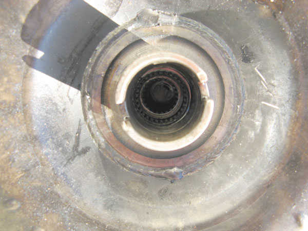

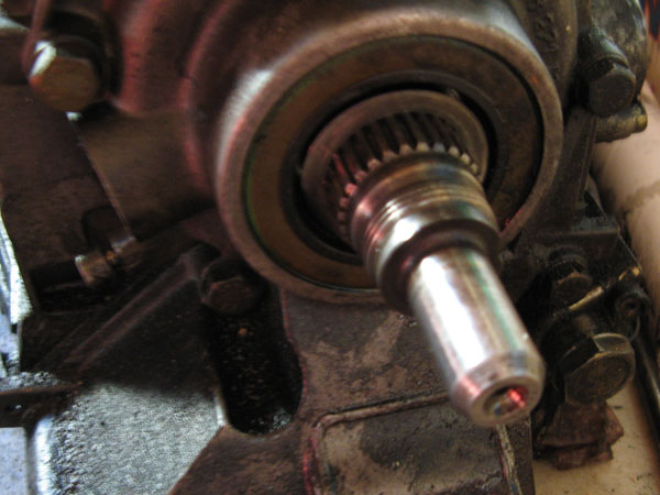

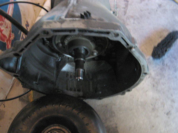

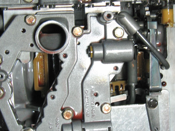

Now I am at a loss. I came home did a more indepth of the vacuume and wiring. So decided to pull the tranny to look at the torque converter and rear end. All looks good. Torque converter is good, the rear end nice and tight nothing out of place. What is the problem that is my question. Is the tranny screwed?
Attached Thumbnails Need Advice... Doesn't anybody know???-mtran3.jpg   Need Advice... Doesn't anybody know???-mtranin.jpg   Need Advice... Doesn't anybody know???-mtran2.jpg   Need Advice... Doesn't anybody know???-mtran1.jpg   Need Advice... Doesn't anybody know???-mtorque.jpg

Look at the pics... does everything look good to you? The transmission has the number 12v=087A3.82

I took the torque converter to a tranny shop and he checked it out said it is good, nice condition. When you look at my tranny pics does anything look out of place. There are no metal filings or bits of dirt when I took out the filter it was clean and so was the fluid. If the nut was out of place couldn't it have seemed like it was causing a hard shift?
