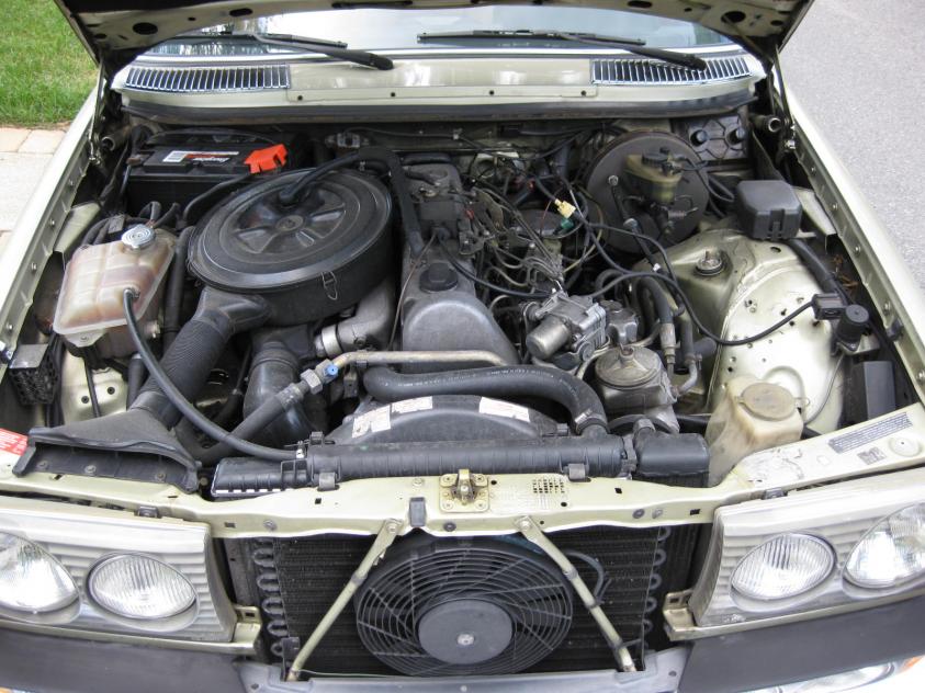

I am wondering if there are any quick characteristics to look for under the hood or on the door tag to tell if a car is set up for California emissions? All the pictures of under the hood on these 300D's (life long Cali cars vs. federal) look the same...i know the air filter is differently shaped, but the filter housing seems to be the same on both as well. Please help. The car i am interested in is located here:

Here are a couple of pics of the car in question's engine bay...Looking to buy 82 300D Turbo...CA Emission Question.-benz-019.jpg

It looks like someone fitted intake and exhaust manifolds that just eliminate the EGR. Also, the A/C has the adapter for an R134a conversion on it, so that's probably been done as well.
