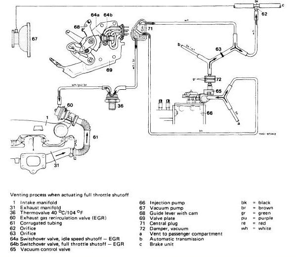

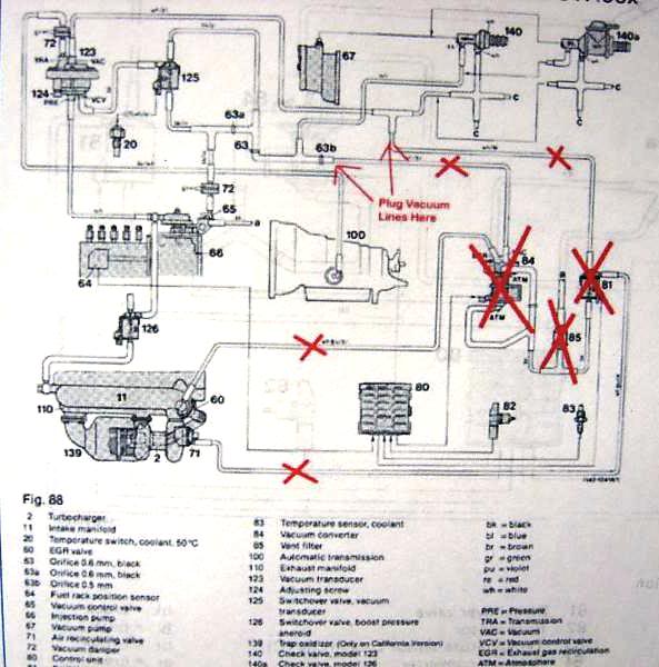

Can any body give a tutorial on how to appropriately delete egr from an 83 300SD? I see a diagram of how to do it for an '85, but they have an electronic switch in place of the Vacuum control shift levers....
I just want to be sure I'm pluggin the appropriate lines, and leavin g the right ones connected etc.
Thanks.
Image below
1985 300SD
Attachment 5476
Image below
1981-4 300SD EGR Vac Diagram
Attachment 5477
te2173 Jun 26, 2010 09:52 PM
Surfsup,
I used two BBs to plug the white (clear) and black lines going to the central plug, item 71, in your lower diagram. I put the BBs in the leg of the "tees" that these two lines are connected to. Use a small screwdriver and poke them down about 3/4". Don't poke them too far or you will mess up the "tee". Then insert the lines again into their respective "tees". Outwardly, it looks like everything is still connected and you could one day re-connect everything if you wanted to do so.
surfsup Jun 26, 2010 10:30 PM
Awsesome thanks for the clarification!
