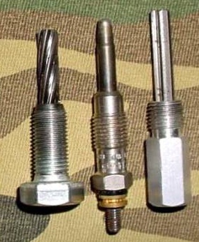

In the pic below on the far right is a Factory Made Glow Plug Reamer as sold by Zdmak and El Paso Tools on Ebay. Baum Tool also makes them and a few Internte Parts Sellers also sell the same one.
The one on the far left is my Homemade version that I make as sort of a Hobby that pays for itself. It does the same thing for less money.

Once again, Thank you very much. You have put my fears on doing this myself to rest. I thought a reamer was going to be a drill bit type, in which I was afraid of messing up the glow plug port. Or just making a mess.
